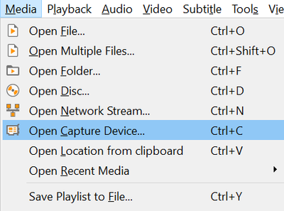

Is there any way to present the audio at real-time? (It means that the PC speaker play FX3 audio concurrently.)

Please try using VLC media player for playing the audio at real-time. The latest version of VLC media player can be downloaded from the following link:
https://www.videolan.org/index.html
After installation, open VLC media player and go to media -> Open Capture Device as shown below:
This opens a dialog box. Change the Video Device Name to None and Audio Device Name to Micorphone (FX3) as shown below:
After this, click on play button. This should play the audio at real-time.
