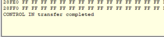

I have tested writing and reading 164 KB of the firmware and I am able to read/write successfully. Following are the steps
1) Erased all the sectors of the flash and read the flash content to check if the erase was successful
2) Writing to Flash
3) Read WIP if SPI flash is busy or not
4) Read data
I have compared the written and read to/from Flash and it matches
Please do not refer to the vendor commands in the snippet as the snippets were taken at the end of the tests
Please share the UART Debug Prints when read/write fails on your board as well as DVK. From the prints, we can know where exactly the read/write fails

Please let me know if you are able to Erase (0xc4) the SPI flash (all the sectors) on the custom board successfully.
If the Erase is successful the WIP will be 00 and only reading he SPI Flash, the contents will be 0xFF.
The data sheet of the SPI Flash M25P40-VMN6TP TR Micron Technology Inc. | Integrated Circuits (ICs) | DigiKey  part mentions bout the write-protect areas based on BP0-BP2 bits. Please confirm if the status of these pins is 0.
Also, let me know if the Flash part on the DVK and on the custom board are same.
The programming through control center fails with the error "SPI Flash Programming Failed" when the 0xC2 (Write) command fails.
With the Flash Prog example we can check where does the failure happen using the UART debug prints. Does the custom board also doesn't have the UART port?

1.I have erased all sectors successful read it all back ,all contents are all 0xff.
Then,try to write img, immediately receive error code 997.
