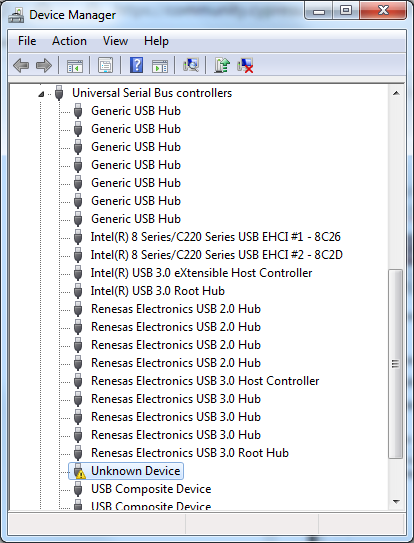

Equipment to simulate system interconnect:
     - StarTech PEXUSB3S4V PCIe  USB 3.0 4 port Card
     - C2G 29525 2-Port USB Hub (required to simulate USB 2.0 environment)
     - Cypress CYUSBS236 DVK Board (2x)
Problem:
Re-connect of Cypress USB device on USB 2.0 hub after opening a session to all COM ports of each device results in Windows "USB Device Not Recognized" message.  Requires (minimum) restart of USB 3.0 Root Hub device to remedy.
Initial connection:  USB Serial Composite Devices on USB 2.0 Hub
Connection after opening & closing session to all COM ports:  Unknown Devices on USB 2.0 Hub

Can you please let me know the below:
1. Are serial numbers assigned to the USB-Devices (CY7C65215 on the CYUSBS236 DVK)? If no, please assign serial numbers and check if the issue still persists?
2. When the CYUSBS236 DVK is connected for the first time do you perform any transfers with the teraterm before disconnecting it?
3.  Can you please share a snippet of the device manager with the issue and the properties of the device with error (general Tab)
4. Is it the same issue with other HUBs as well, or is it specific a single 2.0 HUB.
Yatheesh
1. Both DVK boards have serial numbers programmed
2. No transfers with Tera Term.  Create a new connection and disconnect (must connect to both COM ports).
4. Issue seems specific to Renesas 2.0 hub.  Generic hub doesn't exhibit the issue.

When following the steps defined in the original message, multiple connect/disconnect actions of the CYUSBS236 ports result in the OS not recognizing the Cypress devices for the Renesas and ASMedia hosts.  This issue is not duplicated on the Intel host.
The issue only exists when the USB tree includes a USB 2.0 Hub between the USB 3.0 Host and the Cypress device.

I've seen issues with the following 2.0 Hubs:
  • C2G 2-Port USB Hub Model #29525
    • Bus powered
  • D-Link 4port Model DUB-H4
    • BUs and self powered
I'm trying to find other 2.0 HW to add to the exercise.
A USB 1.1 hub had no issue.
The original issue was found on a USB 2.0 PXIe Switched Hub instrument.

The provided Cypress driver v3.13.0.84 still exhibits the issue.  What USB logs need to be captured and how would you like that done?
The Windows CDC driver does not exhibit the issue.
