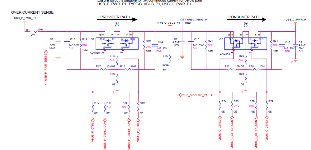

I am checking the circuite described in CCG3 datasheet.
Compairing Figure 2 and Figure 15, there are two MOSFETs connecting to VBUS_P_CTRL but the diection is different.
In Figure 2,   DC-DC <-> Source-Gate-Drain <-> Drain-Gate-Source.
In Figure 15, DC-DC <-> Drain-Gate-Source <-> Source-Gate-Drain.
Which flow is correct or recommend?
Q1) Why do you recommend the order, D-G-S, S-G-D?
>> If I recommend to use S-G-D, D-G-S. there are two cases and fake (The current will streaming through body-diode) one of N MOS FET in this case:
The current from left to right, the first N MOS FET is fake.
The current from right to left, the second N MOS FET is fake.
Q2) Why do we need 2 MOSFET on the line?
>> If there is only one MOS FET, you will lose above explain for both direction. This is the risk. We only design with best practice.
Q3) The current on N-MOS flows Drain to Sorce because gate voltage should be higher than source voltage.
     Why 2nd MOFET conneting to VBUS_P_CTRL1 is sorce is connected to DCDC?
>> Please kindly notice that all of VBUS_P_CTRL1/2 of CCG3 is connected to CCG3.

Hi ,
We are recommend to DC-DC <-> Drain-Gate-Source <-> Source-Gate-Drain.
Below circuits for your reference.

Hello Lisa-san,
Thank you for your prompt response.
I think the following is general inquire but please let me know the reson.
