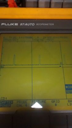

Bernd,
I have tested my circuit with an oscilloscope and discovered some interesting findings (images are attached for reference). When I measure voltage at the ProFET output (pin 5 to power supply GND), I read roughly 6V regardless of PWM input at pin 2. When I attach a load that voltage at pin 5 drops to zero. (I tried with a valve, a valve with a diode in parallel, and also with just a resistor). This voltage remains zero regardless of my PWM setting. Any ideas what I have possibly done wrong?

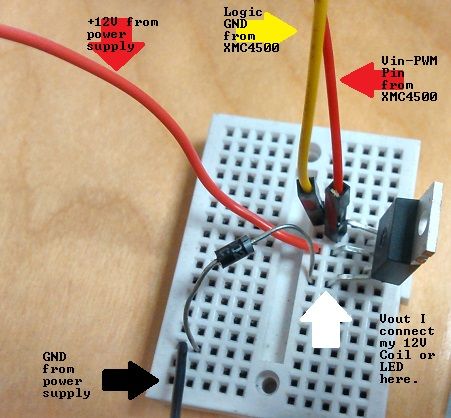

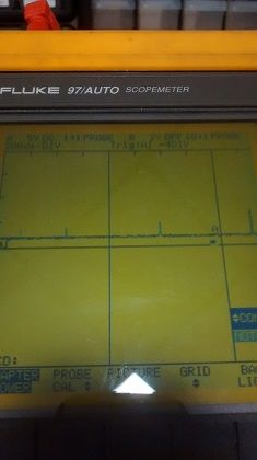

Bern,
That may be possible, I did neglect to place a diode in parallel with the load, however, I have about 10 more, and this time instead of a valve, I used an LED for the load and found the following:
At 0% Duty Cycle I see roughly 1.5V at the output and, with small voltage spikes (picture attached), and the LED was dimly lit.
At 10-90% Duty Cycle I saw 1.5V with small square waves of 12 V (picture attached), and the LED was well lit but its brightness did not change.
At 100% Duty Cycle I saw 1.5V with no spikes (picture attached), and the LED was completely off.
I did also verify that my FET's Input GND and VBB were connected directly to power supply, and placed a diode in parallel with the Load.
Does the fact that I am using a breadboard matter? It seems like I am somehow connecting the FET wrong.
Adam
592.attach593.attach594.attach

Adam,
Using a breadboard does not matter except as you say ´there is a Chance that the device is not contacted or wired correctly. Can you post picture(s) of the breadboard showing all your wiring?
Bernd
Here is a picture of the breadboard connections.
605.attach
With these connections I get no output. I also noticed that my scope reads 10V at pin 4 the status pin. That seems a bit high doesn't it?
Adam

Adam,
Please shorten logic GND (XMC4500) and GND of power supply together.
Bernd
Bernd,
Thanks for your suggestion, it works perfectly now! Thank you very much for the continued support.
