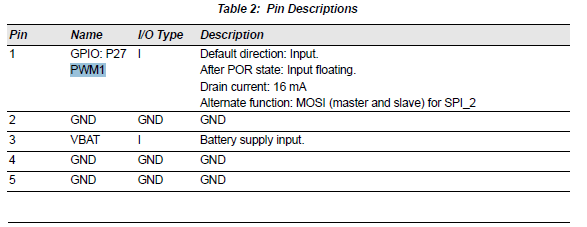

Just not yet clear for me::
MMP920737TAG03-HWUM100-R.pdf, schematics there, shows me that loudspeaker LS1 is connected to P13/P28 (pin 29 on chip, not SiP).
But datasheet MMP20732-DS100-R.pdf shows me:
ADC Port: P13/P28 (select only one), P14/P38 (select only one)
GPIO Port: P13/P28 (Dual bonded, only one of two is available.), P14/P38 (Dual bonded, only one of two is available.)
and:
PWM: P14/P28 (Dual bonded, only one of two is available.)
P13
I) It does not seem to match (P14/P28 vs. P14/P38) and not the same remark on PWM P13
II) How do I know how is it bonded?
In order to use the right PWM3 or PWM2 it would be important to know which port is connected (bond version).
Based on schematics: LS1 is on pin 29 P13/P28, therefore it seems to be PWM2, P28 on pin 29.
It lets me assume that pin 30, P14 is bonded as well, usable as ADC input. It goes to TP5 but there is also LED D3 connected (output, not ADC input).
Because firmware running on the module (2073XS) handles all muxing and abstraction of the physical IO on the internal SOC within the module, it can often become confusing when trying to map IO between the two entities.
Essentially, the module supports 3 PWM channels (4 are supported on the 2073X SOC)
While 4 of these distinct PWMs are mentioned in the 2073XS module datasheets, only 3 can be used at one time.
Note that within the module datasheet excerpt below, both the logical pins (used by the firmware/application) and physical pins are shown.
Note that pwm_tones.c in SDK 2.0.1 provides a nice starting point for PWM usage within an application.
