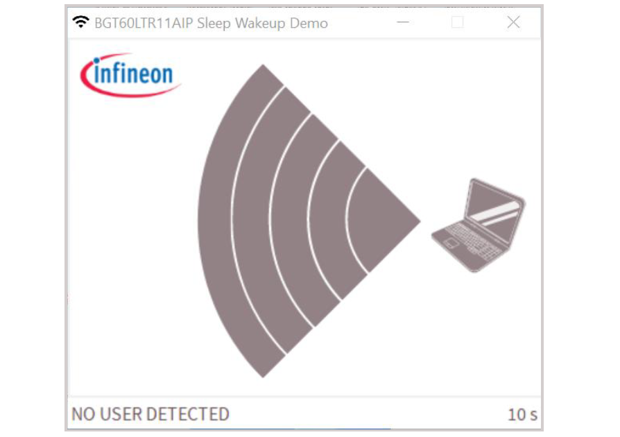

- Go to SW → Demos → Demo1_PC_Sleep_Wakeup
- Double click on demo1.exe to run the demo application.
When a motion is detected in front of the PC, user presence is identified, then the PC screen remains always ON.
Step away from your PC, so that you are out radar sensor range. Once no more motion is detected in front of the PC it will automatically turn OFF the screen and lock after the defined 10 s timeout is reached.
When you approach, a motion is detected, and your PC will automatically wake-up and turn ON the screen.
Note: The project executable (demo1.exe) as well the source code (demo1.py) is already provided within the same package.

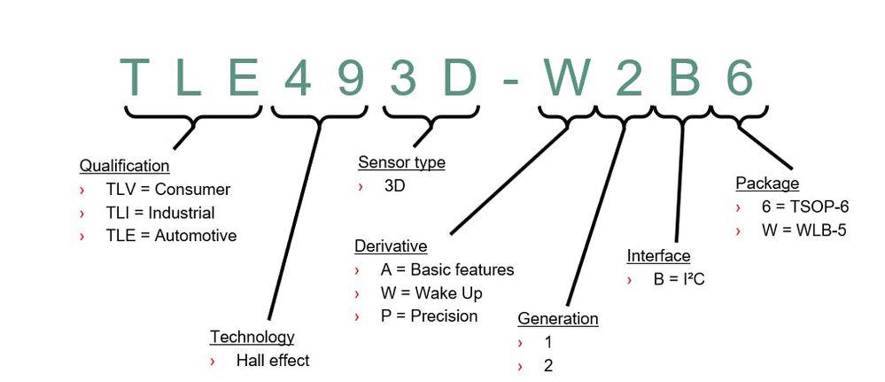

Most likely you find one of our Infineon 3D magnetic sensors:
- TLV493D-A1B6
- TLE493D-W2B6

1) "Say my Name."
The following picture showcases what the name of the IC stands for. For example:

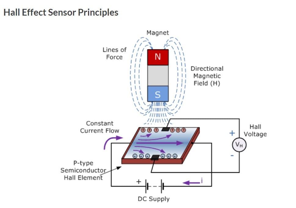

2) Crash Course Hall Effect
Most Hall Effect Sensors are devices that are activated by an external magnetic field. We know that a magnetic field has two important characteristics flux density, (B) and polarity (North and South Poles).
The output signal from a Hall effect sensor is the function of magnetic field density around the device. When the magnetic flux density around the sensor exceeds a certain pre-set threshold, the sensor detects it and generates an output voltage called the Hall Voltage, V_H. Consider the diagram below.
When the device is placed within a magnetic field, the magnetic flux lines exert a force on the semiconductor material which deflects the charge carriers, electrons and holes, to either side of the semiconductor slab. This movement of charge carriers is a result of the magnetic force they experience passing through the semiconductor material.
As these electrons and holes move sideward a potential difference is produced between the two sides of the semiconductor material by the build-up of these charge carriers.
This is the basic concept of how most Hall effect sensors work. For the wisecrackers who want to know more about how the Hall Effect works, check out this article.
The 3D magnetic sensors use three of these Hall effect sensors in one package - thus being able to detect magnetic fields in all three dimensions.

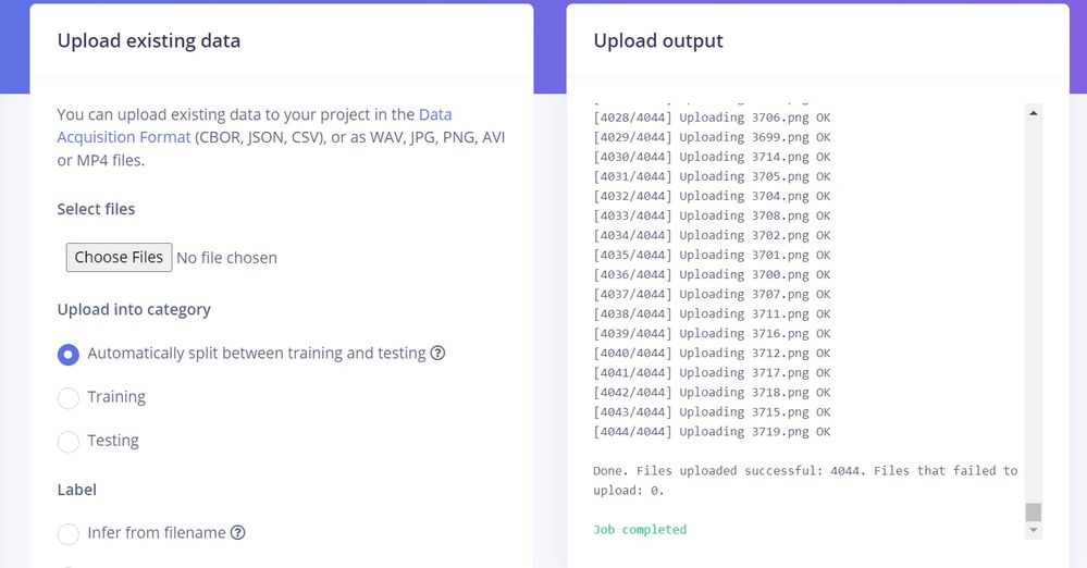

- Now, we see a pop up that asks for the data that is to be used for training. Since we already have the data available, we will use the uploader to upload it from the PC.
- Upload the category of images one after the other giving them respective labels by choosing the files and then click on 'Begin upload'.
