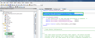

- Open TopDesign.cysch of i2-boot project. And then double click Bootloader_1 component to Make sure that the “Dual-application bootloader” option is unchecked.
- Open config.h file from i2c-boot project head files. Enable define CCG_DUALAPP_DISABLE (CCG_DUALAPP_DISABLE is set as 0u for dual images by default.)
- Compile the project to generate the customized single bootloader binary (.hex & .elf).

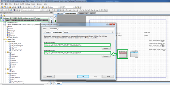

- Pre-build CYPD3125-40LQXI_notebook. cyprj project and generate all relates files.
- Open the CYPD3125-40LQXI_notebook. cyprj project using PSoC Creator 4.2 (the latest version). Double click Bootloadable_1 component and updates the. hex file and .elf file from above process.
- Update Project -> Build Settings -> Debug -> Debug Target from Application Code and Data 2 to Application Code and Data.
- Update linker script for single image build.
- Open the “Project -> Build Settings -> ARM GCC -> User Commands” section and add the following pre-build command.
cmd /c "copy .\Bootloader\CYPD3125-40LQXI_i2c_boot_1_0_3_461_0_0_0_nb.c Generated_Source\PSoC4\cybootloader.c & copy .\Bootloader\CYPD3125-40LQXI_i2c_boot_1_0_3_461_0_0_0_nb.icf Generated_Source\PSoC4\cybootloader.icf"
