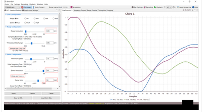

Show LessHello i use Radar fusion GUI do recording and get the xx.raw.txt data.
# Are_Rx_Antennas_Interleaved = 1
# Modulation_Type_Enum = 1
# Chirp_Shape_Enum = 0
# Lower_RF_Frequency_kHz = 6.0238e+07
# Upper_RF_Frequency_kHz = 6.0762e+07
# Sampling_Frequency_kHz = 1000
# ADC_Resolution_Bits = 12
# Are_ADC_Samples_Normalized = 1
# Data_Format_Enum = 0
# Chirps_per_Frame = 64
# Samples_per_Chirp = 64
# Samples_per_Frame = 12288
# Chirp_Time_sec = 6.89875e-05
# Pulse_Repetition_Time_sec = 0.000505637
# Frame_Period_sec = 0.1
# Frame_Number = 19491
0.4884
0.484005
0.477167
0.47326
0.477656
i know the data (0.484005) from analog signal do ADC convet it to value in [0, 1] in default setting.
while i have some question about the raw data.
=> first question about the data, what does the value 0.484005 or 0.477167 means?
does it means the amplitude of the size in analog signal after convert to digtial signal?
=> second question, does the radar sensor data can convert to point cloud data, if yes, how can i do that with SDK api.
thanks
