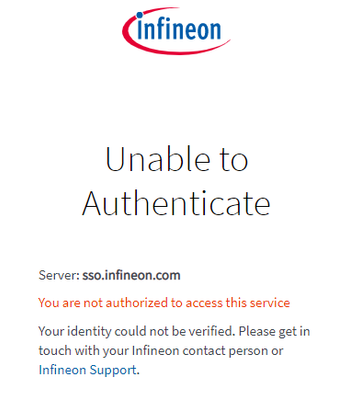

We solved this problem using usb cable has data line. Thank you for your attention. Now I want to talk about our other problem, we didn't access enter collaboration platform. We need to permission for enter this platform. We have already signed NDA with Infineon. We are using Aurix TC35x. Could you please give permission for enter to the collaboration platform. Also I saw that this question and answer related to us situation . In this case, do we need to use a different software than aurix development studio? I am sharing the information required for permission below. Thanks in advance, waiting for your reply.

Deepa_V
First like given 25 likes received 50 solutions authored
Hi @Mehmet ,
To access the collaboration platform, primarily you'll need to get access to the Aurix documentations. For that, please follow the steps below:
Request you to kindly create a case, if you have any further queries on the same !
