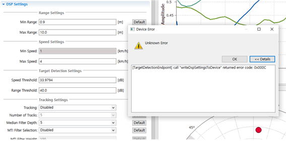

Hello, my name is Kevin and I live in Seoul, Korea.
I purchased the position2go evaluation board from digikey and am testing it.
However, two problems (A and B) have occurred, so I am asking you.
A. The following error occurred while testing the provided function using the Radar GUI.
(1) DSP setting function does not work, and an error occurs when changing the value.
--> In order to use DSP setting function, what kind of work should be done first? ,
--> I'd appreciate it if you could tell me how to solve these problems.
B. I am doing interface programming in python using position2go FW API ver 1.0.1, reading 'DSP setting value' works well, but using 'radar_set_dsp_settings(..)' to change 'DSP setting value' is not being done.
There is no error in using the API, but the DSP setting value is not changed.

Hi Kevin,
Please ensure to use the latest Radar GUI version, v2.8.1 and update the Position2Go FW (P2G_FMCW.hex) which can be updated using the Radar GUI also, and then let us know about your findings.
