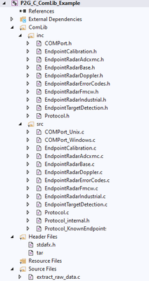

Hello, I need some help regarding the position2go module.
I'm trying to test the "Com_C_lib" example in the package but I'm getting these errors while I compile:
Build/../src/Protocol.c:468: undefined reference to `com_open'
Build/../src/Protocol.c:513: undefined reference to `com_close'
Build/../main.c:70: undefined reference to `com_get_port_list'
I have included all the files in the include and src folders, in addition to adding the paths of the files in the project property but I cannot compile it. I need some clue because I don't know if it requieres to and where to declare them.

Please refer to the 24 GHz radar tools and development environment user manual  document, Section 4.3 C radar system interface for more details on how to run the coding example.
This could be an IDE constraint that doesn't accept long paths. Please try to get a shorter path for your project.
Montassar.
Thanks for the reply but unfortunately is not a problem of long paths, I've already tried and the "24 GHz radar tools and development environment user manual " doesn't say or explain much...
4.3.2 How to use
A coding example to interface with the 24 GHz radar board using C communication library, and to extract raw
data, is available (refer to the extract_raw_data.c file). In order to run this coding example, proceed as follows:
 Go to the /Firmware_Software/Communication Library/ComLib_C_Interface/examples folder, and copy
the path.
 Open your appropriate C compiler, then create a C project.
 Import the extract_raw_data.c file, all source *.c files under /ComLib_C_Interface/src and also all header *.h files under /ComLib_C_Interface/include.
 Ensure that your 24 GHz radar board is connected, then Compile and Run your project to see the raw data.
Figure 33 shows the example running on Visual Studio, extracting raw data from a D2G radar board.
Unfortunately, we can not reproduce the reported issue, please double check your project source files, the extract_raw_data.c source file under /examples contains the main program (I see a seperate main.c file in your shared error list.
Montassar.
I am using the DAVE IDE where I create a new project, import the src and include files. The main file is what would be the extract_raw_data.c
Why using DAVE IDE ?
You can easily create and build a New C Project in Microsoft Visual Studio.
