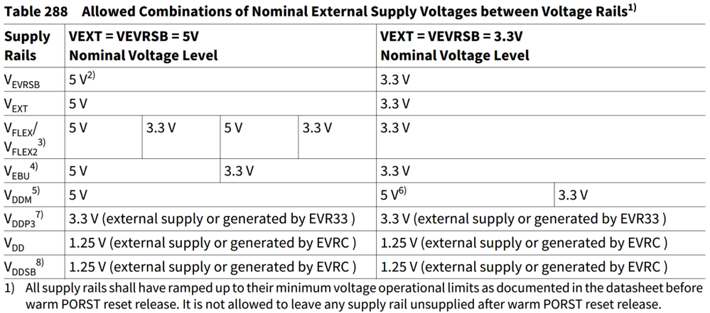

If you review the user's manual section PMS then you will see the operating requirements.
Here are the voltage conditions if you want to have the AURIX in Standby depending on if you want the power rail VEXT powered or not (assuming 5V supply)..
It's clear now! Thank you very much.
