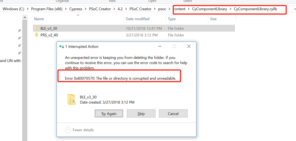

Show LessI tried to update from PSoC Creator 4.0 to 4.1 today. The update stalled. There was no error message or window, just this sitting in my taskbar:
I then tried to uninstall everything and install 4.2 from scratch. That installation stalled in the same spot.
I have gone through: Troubleshooting PSoC® Creator™ Issues - KBA217546
but have not been able to find a solution.
When I run C:\Program Files (x86)\Cypress\PSoC Creator\4.2\Updater\PSoCCreatorInstaller.exe, I get an unhandled exception stating, "The given key was not present in the dictionary"
Any ideas?
