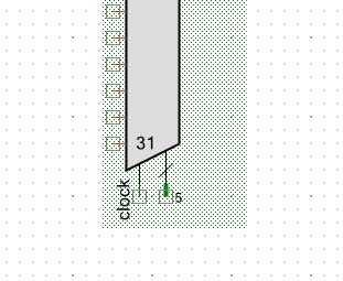

In a test to see if I could route a  64 channel analog mux into a SAR I picked up on
an error associate with mux. It reported, as shown, only 5 address bits, but errored
when I gave it a 5 bit buss. Whn I gave it 6 bit buss it stopped complaing, but you can
see in symbol its still reporting only 5 bits needed.
Regards, Dana.

Dana,
a 64 input mux = 2^6.  Hence 6-bits of the counter is needed not 5.

Yes, but tool is showing buss width at mux is only 5 bits, thats the error, the label
the tool shows. See circled label on the screenshot I posted.

Dana,
You are correct.  It is a limitation of the AmuxHW component.
I imported the AMuxHW component into a project.
I opened the "AMuxHw_v1_50.cysym" file.
I select the "2" highlighted above.
The field came up:
`=($Mode == MuxMode)?(($Channels <= 2)? 1 : (($Channels <= 4)? 2:(($Channels <=8)?3:(($Channels <= 16)?4:5)))):($Channels)`
Based on the above equation, any number of Channels > 16 is treated as 2^5.  There "5" is the largest "n" factor in 2^n.
This might only be a user feedback/visual issue.  The actual feeding of a 6-bit bus (2^6) on a 64-bit mux might still work fine.
Someone would have to code review the ".v" (Verilog) file to determine if there would be a problem.
Update
I've modified the AMuxHW_v1_50 to AMuxHW_v1_51 where the bus width is increased to now support upto 128 Amux inputs (@ 7-bit bus width).
Just unarc the zip file attached into your project directory.  It should show up on the Component Catalog.
Len

It would be nice, if you can tell us which device and component you are using.
This time, I assumed a PSoC 4 and the component is Analog Hardware Mux.
At first I tried a 2-input Amux and it seems to be OK.
Then I tried a 16-input Amux and it seems to be OK.
Then I tried a 32-input Amux and it seems to be OK.
So far, so good 😉
Then I tried a 36-input Amux, this should require 6-bit for selector bus.
But it still shows 5!  This could be a bug at this point.
Then I tried 64-input, which also should require 6-bit selector bus. 
And I think that this is your case, too.
Then I went 128-input, which should require 7-bit selector bus.
Finally the maximum number of inputs, which is 256,
and the selector bus should be 8-bit
So what I observed is that the bit-width of the selector bus in the Analog Hardware Mux
with more than 32-input is incorrect.
I would call it a bug, if I may.
I hope that  Infineon (Cypress) will fix this soon 😉
