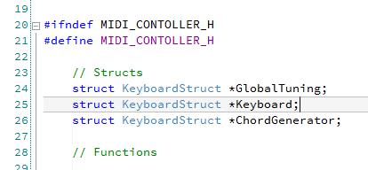

The variable Keyboard is declared in the MidiController.h as follows.
This variable declares a four byte length memory area of a "pointer to KeyboardStruct" as described in the MAP file as follows.
Then where is location of the the structure?  What is the value of the pointer?
I executed "Find In Files" to find where the Keyboard content is assigned but I cannot.
I recommend to declare the structure content like following.
    struct KeyboardStruct KeyboardContent;
    struct KeyboardStruct *Keyboard = &KeyboardContent;

So this is what I did is on my header file I declared the following:
    struct KeyboardStruct GlobalTuningContent;
    struct KeyboardStruct ChordGeneratorContent;
    struct KeyboardStruct *GlobalTuning;
    struct KeyboardStruct *Keyboard;
    struct KeyboardStruct *ChordGenerator;
and then on the appropriate Start function I pointed the pointer to the content, as done below:
void MidiController_Keyboard_Start()
    //start functions goes next
is this right? , I am still getting weird data in some places and want to make sure this is not the reason.

You add following line inside of the function MidiController_Keyboard_Start()
In this case, the LOCAL variable Keyboard is declared and the LOCAL variable is discarded when exiting from the function MidiController_Keyboard_Start() The pointer to the KeyboardContent will not be stored in the GLOBAL variable declared in the header file.
If you want to initialize the GLOBAL variable in the function, just assign the pointer without the type identifier.
It is available to declare the struct without the pointer variable.  But I don't recommend this solution because the operator -> must be replaced with the operator . (dot) in all codes.
Noriaki
