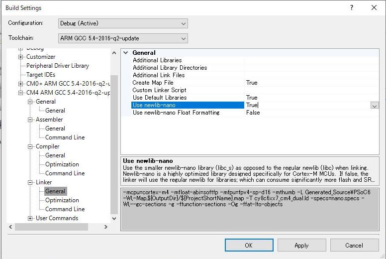

I created two PSoC Creator 4.3 projects in one workspace for the PSoC6 CYBLE-416045-02 on PC "A". I'm also using PDL 3.10.
In both projects, I use the printf() statements liberally.  Therefore it appears that retargetio is working.
I archived this workspace to move to another PC "B".  I build both projects on PC "B" (using PDL 3.10).  The printf()s are working on one project but not on the other.
Note:  _PutString()s on either project work OK.
What am I missing?

As it turns out, the issue appears to be that when I used a copy of the original (working) projects on another PC the build asked if I wanted to remove and in one case rename certain project files I answered "Yes".  That was the issue.  Some of the files that got changed was the  stdio_user.h.  This file is needed to define what SCB to use for the redirection for the printf() calls.  It got defined to a different SCB and that caused the printf() malfunction.

Since both projects are working OK in the PC "A", a
there should not be errors in the project code.
May be some settings have been changed by accident when you moved them to the PC "B".
I would compare Build Settings > Linker settings of both projects.
May be re-installing PDL 3.1.0 also affects something.
moto
P.S. I just noticed, one more thing I would like to try is "Update Components" in the project which is not working.
