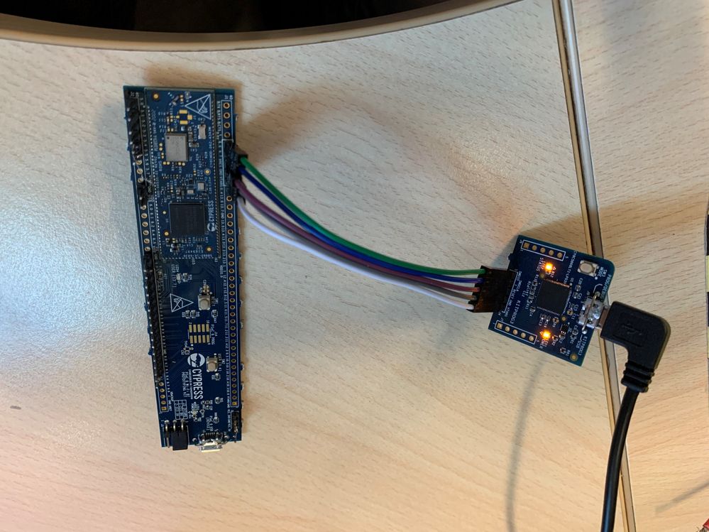

I have broken off the KitProg3 part from the main CYPROTO-062-4343W.
I have used jumper wires between the pins on J4 (on the KitProg3) to the 5 pins on the main board (P6.6, P6.7, XRES, GND, VTARG), but I was not able to program the PSoC6. I have tried both ModusToolBox 2.1 and Cypress Programmer 2.1, but no success.
Here is the error log from Modus:

Syafii,
Not all is lost with the two kits. You just need to make the proper connections between the KitProg3 and the main target board.
I reviewed the schematics and layout of the CY8CPROTO-062-4343W board and found what I think are some discrepancies.
Here's a snip of the block diagram how the KitProg3 connects to the target PSoC6 board for programming and debugging:
Here's the KitProg3 board 5-pin interface connector J4:
Officially there is no 5-pin connector on the PSoC6 target board. The connection should be made before resistors R49, R48 and R47.
The next issue I see is the issue you are having with no target board power.
The VTARG connection of the KitProg3 J4 connector is not sourced from the KitProg3 board. It is sourced from the PSoC6 target board.
If you connect to the target PsoC6 board with a powered USB cable to J10 as Rakshith M B recommended the VTARG gets powered with 3.3V as needed and all is well. This is because J10 takes in the 5V from the USB and regulates it down to 3.3V needed for the PS0C6 to become VTARG.
The VTARG on the KitProg3 is ONLY a voltage monitor pin used for the PSoC Programmer and for the display during programming such as:
Info : VTarget = 0.033 V
There is no 5V to 3.3V regulator on the KitProg3 board.
DO NOT connect VBUS or P5LP_VDD from the KitProg3 to VTARG! VBUS and P5LP_VDD are 5V and will destroy the PSoC6. (Max voltage = 3.6V)
It is best to find another source of 3.3V to supply the PSoC6 target board. A powered USB connection to J10 is a good choice.
Here's a snip of the circuit that provides the source power from either the USB J10 or from the KitProg3 board:
The VBUS connection to the KitProg3 board is a wired connection that gets broken when breaking off the KitProg3 section from the CY8CPROTO-062-4343W. Sadly, there is NO header connector interface. You can solder a wire from J4 pin 1 to one side of R89. this should reestablish the power source from the KitProg3.

Hi SySa_4665481,
This error generally shows up when there is an issue with the connection to the PSoC target device. The same error also pops up when I try to program the device with the reset button pressed -
Can you please confirm the SWD connections again? Are they connected to anything else?

Hi RakshithM_16,
Thank you for the reply.
The setup is as shown.
Strangely, when I probed VTARG, there is no voltage there.

If I were to power the main board separately, I got the error messages as shared in previous thread.
Hi SySa_4665481,
This should not be the case. I have a CYPROTO-062-4343W kit with me. I checked the voltage at VTARG and it is 3.3 V for me.
Can you disconnect the KitProg, connect the micro USB cable to micro USB connector (J10) on the Kit, and measure the voltage at different power lines?
Also, can you measure the voltage VTARG of KitProg without the connection?

hi RakshithM_16,
Powering Kit via J10:
VTARG = 3.3V
KitProg without connection:
VTARG = 0V

Syafii,
In you later post I noticed:
It would appear the target board is unpowered.
Before you broke apart the boards in the kit, were you able to get the KitProg3 to program the target board?
Len
"Engineering is an Art. The Art of Compromise."
Hi LePo_1062026,
No, I could not program the target board after the broke them apart.
Yes the target board is unpowered after I broke them apart.
I also tried powering the target board via J10 as suggested by Rakshith, but no success.
It's a bit of a disappointment, I had lost 2 good boards because of this.

Hi SySa_4665481,
I snapped off the KitProg3 board and connected the SWD lines using jumper wires. As you have mentioned I was not able to program the device. But when I powered the device using micro-USB port (J10) I was able to connect and program the device.
Is there any firmware running on the device? If so, can you please confirm if the PSoC 6 is still functional?
Can you please share a screenshot of Cypress Programmer when you are trying to connect to the device? The KitProg3 should be monitoring the target voltage and that can be observed using the Cypress Programmer tool.
Can you also try connecting the VTARG pin of PSoC 6 to 3rd pin of J7 header (J7.3) of KitProg3 module and let me know if this helps?
