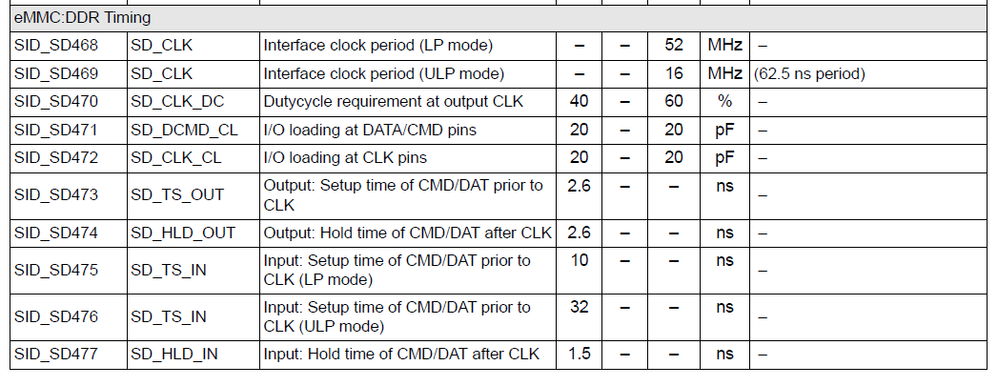

Hi PSoC Experts,
I feel confuse on the Spec of PSoC6 2MB and MTB2.x PDL document about SDHC DDR.
In the datasheet and TRM, PSoC6 SDHC support DDR, but current version of PDL document and source code are not include the support about DDR.
TRM:
Datasheet:
psoc6pdl -> html document SDHC portion:
psoc6pdl -> cy_sd_host.h
I want to clarify that does PSOC6 2MB can support SDHC DDR50 ?
If yes, does it mean the current PDL not support the DDR? When will it be supported?  Can we support DDR by write the Register bit mention in TRM?
Ray

Hi JiaweiL_16​,
The PDL and HAL SDHC drivers do not currently support DDR50 speed mode. But the SDHC hardware block does support DDR40 at 1.8V signalling as mentioned in the PSoC 6 MCU: CY8C62x8, CY8C62xA Architecture TRM​ -
You should be able to write into the HOST_CTRLx_R registers to enable DDR speed mode. Please refer to the  Cy_SD_Host_SetHostSpeedMode function implementation in cy_sd_host.c PDL file. You can modify the function to write appropriate values as mentioned in Architecture TRM to enable DDR mode.
Please refer to the page 1545 of Register TRM for more details regarding the HOST_CTRLx_R register.
