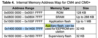

While running code, i.e. executing from the built-in flash, is it possible to do non blocking writes to the Auxiliary flash section?
same question goes for erasing it.

hi ekta,
writing and erasing to aux-flash/emulated-eeprom while the application is running, i.e. from the application. its important that it is non blocking
to clarify, this is the 32KB flash area that is in the psoc6 itself

thx, I'm more after if this part of the flash is segmented somehow, cant find that in datasheets
i.e. do writes to application flash block aux?
how does it work on a physical level?
