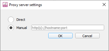

Hello @Bill_Joseph ,
We have observed this issue in the China mainland with Github being blocked by China's network infrastructure. Are you also based out of China?
Please try accessing this link in your browser and see if the page loads: https://github.com/cypresssemiconductorco/retarget-io/
Looking forward to your reply 🙂
Yes this problem is because of China's network infrastructure blocking access to GitHub. Please try opening the Github link several times in the browser, you will notice it fail intermittently.
Since this is the primary mode through which our application creation process works, you might need to use the offline content libraries until this issue is fixed.
You can find more information on using offline libraries here: https://community.cypress.com/t5/Resource-Library/ModusToolbox-offline-libraries/ta-p/252265
Also, see Page#56 for more information on this in the linked User Guide: https://www.cypress.com/file/520251/download

Hello @wade_4843926 ,
Since you are using a VPN, please configure the proxy settings. To do so, in the Project Creator window go to Settings > Proxy Settings and add in your proxy settings.
Let me know if it works with this change 🙂
Dheeraj
YunHuaD_81
10 sign-ins 5 replies posted 5 questions asked
How to set "Proxy Settings" for Infineon GC net?
