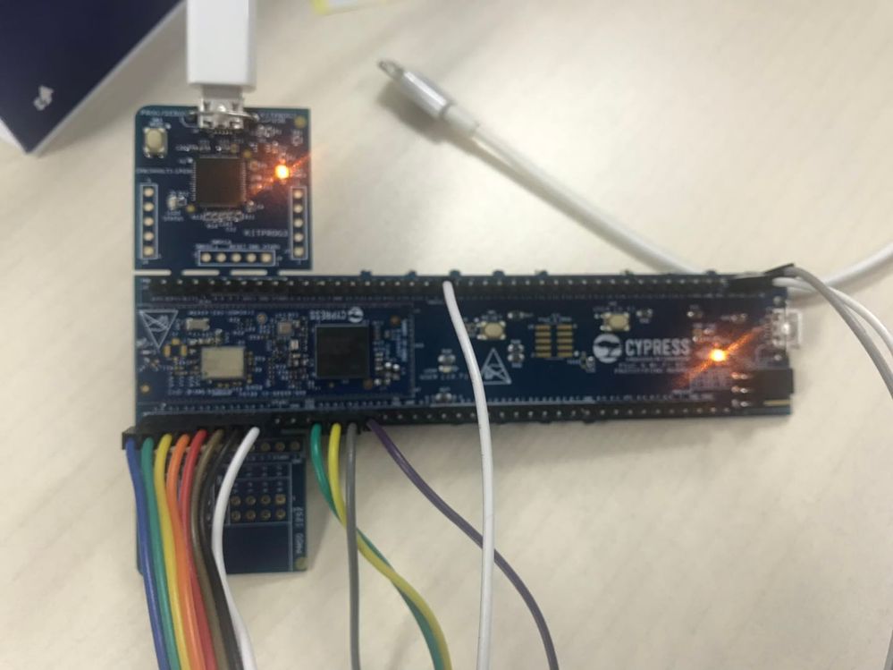

Dears:
we try to use CY8CPROTO-062-4343W drive CY8CKIT-028-TFT ,use ModusToolBox 1.1 ,use TFTemWin example ,modify pinout as following:
and we download the code into board ,but TFT display no response
any other pin need to connected ?

Can you tell me if you have matched the configuration of your PinOut with that of the original code example PinOuts, that is, the drive mode and the Initial drive state of the pins

in ModusToolBox 1.1 new Application--> select CY8CPROTO-062-4343W --> TFTemWin
I configure the 8080 I/F pin as strong output mode ,it works ^_^
