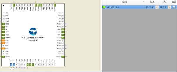

Working with board -059, I am trying to join two output pins (digital outputs) in order to feed more current to a sensor (ganed pins):
The C code I write is the following:
When I download the code to the -059 board, without connecting together  both pins, only one pin outs the pulsed signal (0-5 v), and the other signals always 0v.
When I connect both pines together, the signals is just 0-2.5 v...
What am I missing?. Am I properly calling every pin on the c code? My intention is to get a single ganged signal pulsed with 0-5 v.
Thanks for the answer

Please replace your code " Pin_Write(1); " with "Pin_Write(3);".
Because if you ganged the two sensors, you should use two bits to control it.
LinglingG_46
1000 replies posted 10 questions asked 5 questions asked
Modify: Pin_Write(1); to Pin_Write(3);
You can check the source code :
void Pin_1_Write(uint8 value)
    uint8 staticBits = (Pin_1_DR & (uint8)(~Pin_1_MASK));
    Pin_1_DR = staticBits | ((uint8)(value << Pin_1_SHIFT) & Pin_1_MASK);
