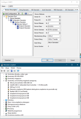

I have problem with USBFS. I configured usb descriptors like below.
I don't know why, when i plug my psoc 5LP to my computer sometimes it's works, and sometimes not.

I've set that to 0x00 but it also not work as expected.
Have you tried any of the USBFS project examples provided by Cypress?
If so, is any example similar to operation and configuration?
"Engineering is an Art. The Art of Compromise."
I don't understand that when I set 0x02 (CDC) Device Class my computer also doesn't recognize my USB. I've tried Cypress examples, there everything works, but when I create on USBFS based on exactly the same USB Descriptor Settings it's completly failed. Why? I use every settings the same.
Here is a screen
As I understand if I set Device Class to 0x02 (CDC) my computer would install the default drivers to CDC communication. That's not happening.
Again, I'm not an expert of USB protocols but I'll venture a comment.
Observations:
I modified the Cypress USBFS UART example (CDC class) with your PID of 0x8051. It worked.
However I noticed in your USB configuration above the "Configuration Descriptor" you recently posted doesn't even come close to matching the CDC UART descriptors in the USBFS CDC UART example project.
Are you trying to create a 'custom' USB interface?
If so, which type of standard USB interface comes closest to your custom interface requirements?
