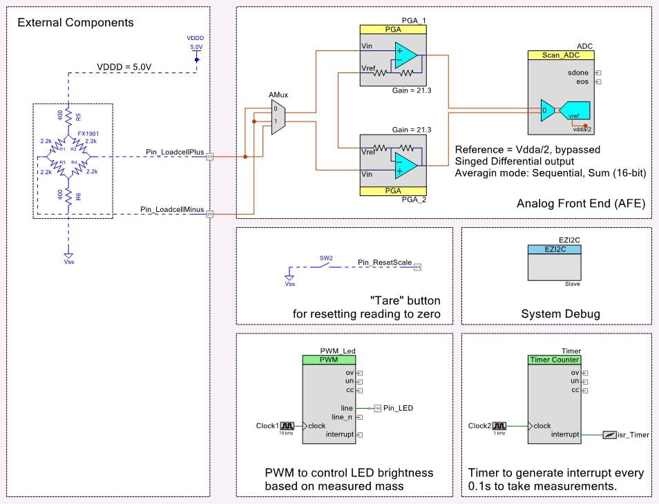

One way I think might end this problem is the application of CDS and IIR solution ( https://www.cypress.com/file/119666/download ) with the PGA but I have no idea how the top design would be.
https://hackster.imgix.net/uploads/attachments/224249/lZl0z872sarenc1gNDE2.png?auto=compress%2Cformat&w=1280&h=960&fit=max
Would be something like the application above maybe but with the delta sigma replacing the Scan_ADC?

I recommend to try this solution first:
HX711: 24-bit Delta Sigma ADC interface for weight scale
This is ready-to use project, using HX711 24-bit DelSig ADC, which is available elsewhere for under $1. Regarding the achieving accuracy of 1g using 20kg load cell (5E-5), please check the attached datasheet Appendix 1, which covers a demo project provided. Using 1kg load cell and a median filter, the short-term accuracy was about 30mg (3E-5), which matches your requirements (but is quite tight!).
Due to load cell signal creep (deformation + temperature drift) the scale should be "tared" after each weighting cycle.
I don't recommend using IIR filter (neither FIR) for weight load application. I find that median filter works best in this case (rejects load spikes and settles faster)
MedianFilter: sliding window median filter component
Though your approach is entirely doable, I don't recommend it for a beginner project. Another advantage of staying with HX711 is that less expensive processor (PSoC4) can be used instead of PSoC5.

Hello, Bota
Thank you for your help.
I'll try the solution with HX711 but the problem with that set will be the SPS. I think I'll need more than just 10 SPS.
I saw that there is a shielded version that some people say that works better. Maybe changing the rate to 80 SPS will end the problem...
Dou you have any ideas about the sample rate?
Thanks again.
EdDr,
I recommend to start with existing design and follow up with improvements. For example, the HX711 allows for external clock input, so you can easily speed-up input A from 10Hz to e.g. 20Hz. I don't think the sampling rate is important here; technically you need only one good ADC measurement per load (1 Hz). Note that oversampling of Delta Sigma ADC will not improve S/N.
I am expecting that accuracy of the device will depend on simple things like quality of the load cell, load cell temperature stabilization, device shielding, power supply stability, weights loading mechanism, etc. ----  Not by the PSoC or ADC design implementations! My advise is to get some results ASAP, and then to roll hot potato over to the management: "options A, B, C will cost that, that and that and will take so much time, etc." (brutal force "project management").
/odissey1
