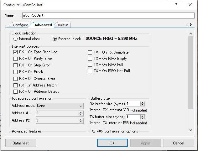

Although I have not read your project well,
but at first glance I noticed that you left the buffer size of UART as default 4 bytes
Since you know that the size of data is 288, how about make the buffer size as large or slightly bigger?
In the following screen shot I set it to 300.
moto

> Unfortunately after a random number of times (usually under 20) one of the Uarts has a Timeout
> because it receives less than the 288 bytes.
I think this symptom happens when we fail to salvage data from the UART RxBuffer before more data is incoming.
Since you are sending 288 bytes, but the hardware buffer is only 4 bytes,
and an interrupt takes dozen of cycles to call and return, dropping data can easily happen.
So just for test, could you increase the UART rx buffer size to 300 or at least 16 or more to see if there is/are any improvement?
moto
I would need to rewrite my library to do this because making the buffer greater than 4 enables the IRQ which will not pair well with my interrupt that is already servicing the uart. Also the IRQ interrupt routine is very large compared to my small Interrupt routine. Will try to use it though.
