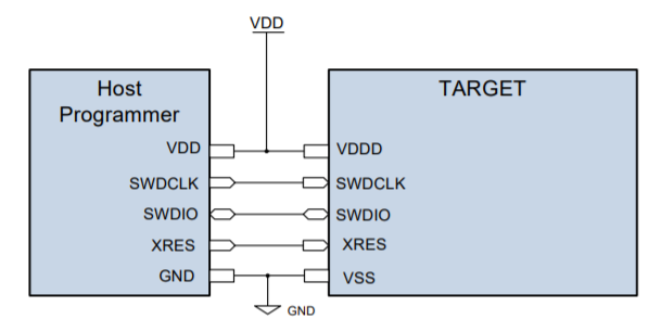

is it possible to program psoc4 prototypig kit using psoc5

Yes, you can use the onboard Kitprog programmer/debugger which comes with PSoC5LP Prototyping Kit to program other Cypress Developed kits. Just ensure you make the following connections:
