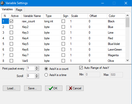

I am looking at measuring capacitance reading as raw count in Bridge control panel using CY3280-MBR3 Evaluation kit. However I am unable to register any output chart in the control panel. I am using I2C mode. Does anyone know whether my editor configuration is right?

To plot the chart in bridge control panel, the following steps have to be executed:
In Bridge control panel (BCP) set the variable. Go to chart-> variable settings
Give a variable name and click on OK.
In bridge control panel, write the following command
w 37 82 04 p
where 37 is the address of MBR3, 82 is sensor ID register, and 04 specifies the sensor. (CS4 in this case. change this to the sensor you want to plot).
Ensure that this is transmitted correctly by checking the '+' sign at the end of each data.
Then send the command to obtain raw count value.
w 37 E2 r 37 @0raw_count @1raw_count p
Send this command continuously by clicking on the Repeat option. In the chart tab, you will see the raw count plotted.
Please try this out and let us know if you are able to obtain the raw count information.
