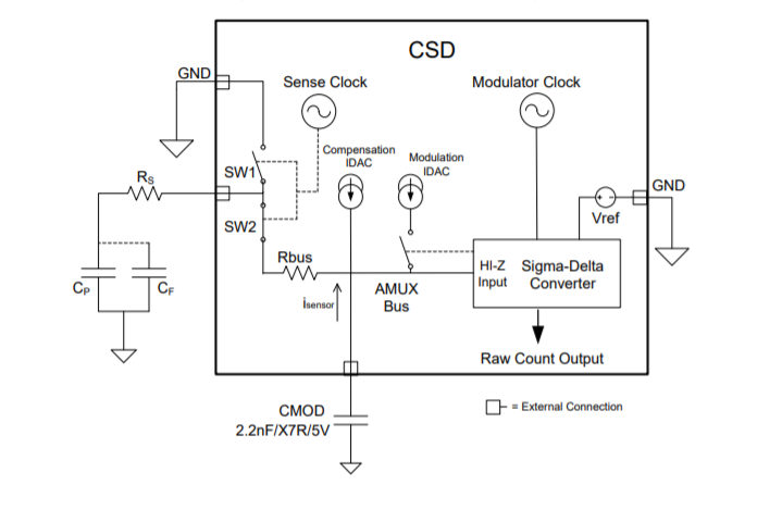

And I have another question now, I cannot understand nothing from user manual.
What does Cmod do?
Manual says:
Ensure that the CMOD is not adjacent to any switching/communication pin. Since there is an analog signal on CMOD, it should be surrounded by the CapSense (analog) signal rather than being surrounded by the switching/communication (digital) signal. Ground of CMOD should have a least possible path to device ground.
The decoupling capacitors and CMOD capacitor must be connected as close as possible to the chip to keep impedance of the ground and supply traces as low as possible.
CSD requires one external capacitor called CMOD for operation
But what it does - a totally cannot understand. Why and where it's need?
Thanks!
Hari
750 replies posted 500 replies posted 250 solutions authored
Hi jade_4415151
Cmod is an external capacitor that is required for CapSense operation. For detecting a touch, the CapSense component detects the change in capacitance of the sensor. The CapSense sensors are charged and discharged periodically (depending on the sense clock frequency). The charge that is needed to charge the capacitor to Vref will be different in case the sensor is touched (since capacitance is different).
Initially, before each scan, the Cmod is charged to Vref. Then, once the scan begins, the sensors are charged and discharged from the Cmod capacitor (with the help of switches that switch between Cmod and ground). The block inside detects the small voltage variations in Cmod cap and this change is used to determine the capacitance of the sensor.
This is the reason an external cap is needed to CapSense design. It is also the reason for adding a limit on the trace length. An increased trace length will result in variation in potential from the cap and the IC and this may cause erroneous measurements.

Thanks for explain!
So.. Should 2,2nF capacitor be necessarily present in system or only in some cases?
Because now I use 30 CapSense pins + (maybe) will use Shield. trace length ~10 cm and everything now without that capacitor, seems work pretty well. So how should I understand this?
Hari
Hi jade_4415151
-> The 2.2nF capacitor is mandatory for any CapSense design. If you are using a kit, it is possible that the kit already has a 2.2 nF capacitor populated in the designated pin.
For shield, a tank capacitor (Ctank) is required only if the parasitic capacitance (Cp) of the shield is greater than 100pF.
Please probe the sensors and shield pin and make sure that the capacitors are getting charged and discharged completely. You will observe a waveform similar to this:
