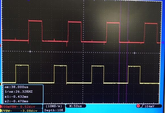

Hi all,I want to set an output like below pic,the period of 100%(duty cycle) is 60 us another one(20%)  is 120 us
but the result on oscilloscope is not what I want,how can I do?

Usually PWM component generate 0 and 1 output.
If you want to have 100% and 20% output,
you can either use IDAC or DC bias PWM output.
So I tested with CY8CKIT-044
schematic
pins
main.c
#include "project.h"
void init_hardware(void)
    CyGlobalIntEnable; /* Enable global interrupts. */
    PWM_Init() ;
    IDAC_Start() ;
void ConfigPWM(uint16_t period, uint16_t compare)
    PWM_Stop() ;
    PWM_WritePeriod(period) ;
    PWM_WriteCompare(compare) ;
    PWM_WriteCounter(0) ;
    PWM_Start() ;
void ConfigIDC(uint8_t value)
    IDAC_SetValue(value) ;
    init_hardware() ;
    ConfigPWM(180, 60) ;
    for(;;)
        IDAC_SetValue(100) ;
        CyDelayUs(60) ;
        IDAC_SetValue(20) ;
        CyDelayUs(120) ;
The result oscilloscope view was
The red signal is output of IDAC via 2k (kind of 100% and 20%)
The yellow signal is output of PWM (100% and 0%)
Since IDAC is controlled by FW, they are not synced.
moto

This is my solution for your request using CY8CKIT-044
This project consists of two PWMs.  The PWM_FAST generates 20%/100% duty waveform. The PWM_FAST is controlled by PWM_SLOW.  When the control signal is HIGH, PWM_FAST generates 100% duty sticking at HIGH.  The configuration of PWM_FAST is as follows.
Please set the input mode of three input signals proper.  The carrier frequency of PWM_FAST is set to 1.2MHz (24MHz/20)
PWM_SLOW generates 60us/120us waveform with following configuration.
Because I have no oscilloscope in home, I confirm the behavior with a handy DMM by decrease the control signal.
Please confirm the waveform with your oscilloscope.
Noriaki
