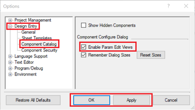

- In PSoC Creator, go to Tools -> Options.
- Go to Design entry -> component catalog and check the checkbox for "enable param edit views". Apply the changes.
- Go to CapSense component, double click to open the configurator. Right click on the Advanced tab and select "Show expression view"
- Change the value of CsdRawCountCalibrationLevel to the desired value.
