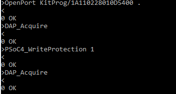

When use of ppcli.exe with the PSoC4_EraseAll command we get Error when PSoC4_ProtectAll has been used.
How do I remove the protection again?
I can write to the device again with "PSoC Programmer" but I cannot find a way to erase/overwrite it again with ppcli.exe
see attached script.
First time it run successfull but second time it fails.

Hi KlJe_3653291​,
This is a known issue and I tried this to reproduce the issue.
1. Change ChipProtection to Protected in PSoC Creator and build the program.
2. Program using PSoC Programmer.
3. Using PPCLI acquire the device and perform erase all as shown -
As a workaround you can try the following -
1. Acquire the device and then change the chip protection to 1 (Open) using PSoC4_WriteProtection() API. PSoC4_WriteProtection() performs an erase internally and thus the entire flash will be erased.
2. Reaquire DAP
I performed a read to log action after this using PSoC Programmer and confirmed that this erases entire flash -
You can also perform erase all after changing the protection setting as shown -
Hope this helps.

This is working perfect! you are brilliant 🙂
