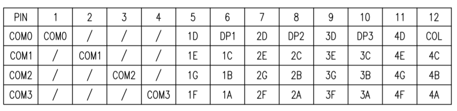

Please share the datasheet of the Segment LCD you are interfacing with. It will contain information on the number of segments and commons you need.
Dheeraj
Hi Dheeraj,
I'm working with 7 segment LED display, and it's common anode type. It doesn't need any specific command for it's operation. To interface single digit segment with PSOC 4200L device, I followed this video tutorial
PSoC 4 - Display 7 Segmentos CY8CKIT-042 - YouTube
I'm trying to extend this understanding for a 4 digit display with help of datasheet provided for LCD segment by cypress and not being able to figure out which step I'm missing or doing wrong.
Ashish
Every Segment LCD has a segment-common mapping table. You need to assign each pixel to right segment-common in the Display Helpers tab in the Segment LCD configurator.
For example, suppose the datasheet for your 7 segment LCD (with decimal points) has the following mapping table:
Then you would do the mapping as follows:
Please share the LCD datasheet if you need help with the mapping.
