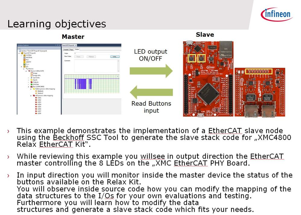

This training shall guide you on how to create an EtherCAT slave using the XMC4800 relax kit and DAVE4 apps. It provides the instructions on how to do the memory mapping of the EtherCAT Salve and also to integrate the Slave Stack Code into the DAVE4 project.
Lastly we shall make use of the EtherCAT Master (TwinCAT2) to control the ON/OFF of the LEDs and monitor the buttons of the XMC4800 relax kit.
