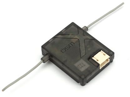

The DSMX-Receiver (Sattelite) we were handed comes with a AR6210. Sat. and AR6210 comunicate with eachother over a serial Interface with 115200 BAUD 8N1.
In order to decode the Information sent it is necessary to read 16 byte and then do some shifting with the bytes. This aproach does not offer any failures for us.
We ported this python script to C/C++ and it works fine without any failures.
http://api.ning.com/files/kMyzkPYXBOF-sKuYWJXrKJd5YEup95t9mA-tCfsmai2lj*rlM5g5BGK8scoNV8HaWsXNjR9bU2...
FYI: We first had to bind Sender and Receiver as usual, then we detached the AR6210 from the Sat. Afterwards its pretty easy to pin the 3 wires of the Sat.
Red = 3.3V
Black = GND
Gray = Serial-Data (115200 8N1)
(image from: http://www.horizonhobby.co.uk/aeroonline/e6spektrum/e6receivers/e6-receivers/e6-remote-receivers/e6-...)
Decoding works with standard C-Libraries such as fcntl and termios.
Up to know we just read one Character at the time, since we have not managed to read the 16 Characters on one time. read() just returns a max. of 8 Characters on one run. Nevertheless this snippet should visualize how we decoded the stream coming from the DMSX-Sat.
The data array now contains int-Values between 0 and 2000 for each joystick. Selecting the right model on the Spectrum Sender, enables getting some of the switches on the Sender into some channels transmitted. In our case, we use the GEAR-Switch to change between autonomous flight mode and manual flight mode

int n = read(handle, &input, sizeof(input));
if(n>0)
ReadBufRC= input;
s++;
if(s==16)
for(i=0;i<16; i+=2)
chanID = ReadBufRC >> 3;
data[chanID] = (ReadBufRC & 0b111) << 8 | ReadBufRC[i+1];
// asigning the gathered values to the corresponding variables
QuadCopter.SET_throttle (data[0]);
QuadCopter.SET_aileron (data[1]);
QuadCopter.SET_elevator(data[2]);
QuadCopter.SET_rudder (data[3]);
QuadCopter.SET_Gear (data[4]);
s=0;
