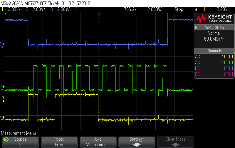

One of our boards has a problem while reading the device id of S25FL064L. Design is consist of the multiplexer, ethernet controller, nor flash, and spi header. We can select either an ethernet controller or spi header. When I selected to spi header, nor flash does not respond to the manufacturer id etc. I can read only 00 from spi emulator.
When I selected to ethernet controller, the MOSI pin seems weird. You may see that the signal level is about 1.6V. Flash also drives the MOSI pin. I think that nor flash was wrongly configured. ( I do not know how it is) It may be in QSPI flash mode.
Is there any way to exit from this mode using normal spi reading or writing?
