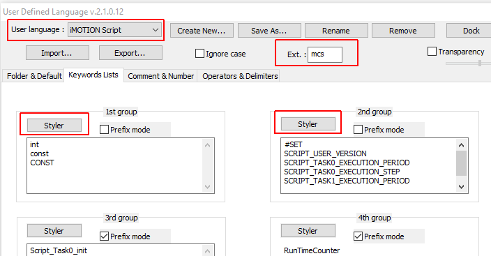

1) syntax highlighting
npp comes with syntax highlighting for a lot of predefined languages but also allows the definition of ‘user defined languages’.
The attached file “iMOTION Script udl.xml” contains the keyword definitions for iMOTION script based of MCE rev. 1.3.1.

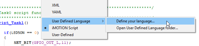

Importing into npp works as follows:
- from the ‘language’ menu select ‘User Defined Language’ => ‘Define your language’
4595.attach
- Import the xml file
This will give you the keyword groups as well as the operator definitions etc.
4597.attach
The actual highlighting style is a rather subjective thing - fell free to adapt it to your personal preference via the Styler buttons.
Documentation for the udl can be found here:
https://ivan-radic.github.io/udl-documentation/

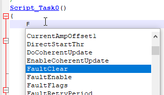

2) auto completion
Since it’s hard to memorize all the parameter names etc., we defined an auto completion file which contains the parameters as well as the symbols, functions etc.
Installation is done by simply copying the file ‘iMOTION Script.xml’ into the subfolder ‘autoCompletion’ in the npp installation (program) directory.
This requires admin rights.
Auto completion is enabled and configured in the preferences.
Depending on the setting npp will make suggestions right while typing or after hitting STRG+SPACE.
4598.attach
For functions on entering the opening bracket there is a short description plus the parameter list, which will be highlighted while typing.
