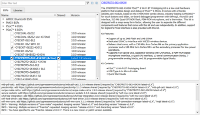

Here is the Library manager dialog for yet another try to build the project
What does this mean?
I do not see any libray for MBEDTLS?

Rakshith
Hi @skruglewicz
Can you please share the mbed config file (mbedtls_user_config.h)? If possible, please share the entire project so that we can try it out at our end.
The mbedtls library should be listed under the Core section in the Libraries tab. You can also search for mbedtls and the library should show up -
The warnings in Library Manager just indicate that there is a newer version of some of the libraries in your application. You can choose to upgrade the library or ignore the warnings.

I tried the new project that you shared. I placed the zip file in a new folder named MTB, extracted it, and created a ModusToolbox workspace in the MTB folder. In the Eclipse IDE for ModusToolbox, I clicked on Import Application and selected the extracted Nanodrone-II_PSoC6-3.1.0 folder.
Although this imports the project into the Eclipse workspace this does not import the libraries. I then opened Library Manager and added the CY8CKIT-062S2-43012 device as shown and clicked on Update.
This imports all the necessary libraries. I built the project to confirm that the build works. I then opened the Library Manager, changed the active device to CY8CKIT-062S2-43012, and built the project again. In both cases, the build was successful.
Please let me know if this helps.

Hello Rakshith
SUCCESS....... I am able to build the project.!!!
I had followed your directions above exactly and was getting the error I described. The only difference was that I modified the Makefile in the editor, setting TARGET=  and then I updated the Library
By only editing the Makefile this did not work . But if I understood what the comment above the variable meant as.  "run the Library manager assuring the kit is selected and set as Active (using the select boards right-click menu option Set Active)).", I would have had success on the first try. Apparently you can't just  change the makefile without setting the board as ACTIVE in the library manager. in the GUI version.
It wasn't evident in the GUI, that you had to perform a Right-Click and select "Set Active" from the only option on the menu. this was the whole reason my import of the project would not build.
To build successfully I simply changed the  kit name to active as described below and then I pressed the "Update" button.
After the update was done. I closed the library Manager. I built the project from  the project right-click menu Build this time, instead of in the quick launch BUILD. I don't think it matters.
To import and build a project that uses a different board you need to build the BSP library So the steps are in the GUI on ModusToolbox 2.4 are:
  1. Unzip repo to a directory under you workspace.
  2. Import the project folder . Using the quick launch "Import Application" option
  3. Run the Library Manager from the Quick Launch "Library manger 1.40"
    1. Select the Kit you using by checking the Checkbox.
    2. On the board name, Right-Mouse-click, select "Set Active". Observe the board name changed to include ACTIVE
    3. Press the Update button to Build the BSP.
    4. Close the library manager.
  4. BUILD the project using the Quick launch "Build  <project name >"
Thanks for all your help
Steve K
