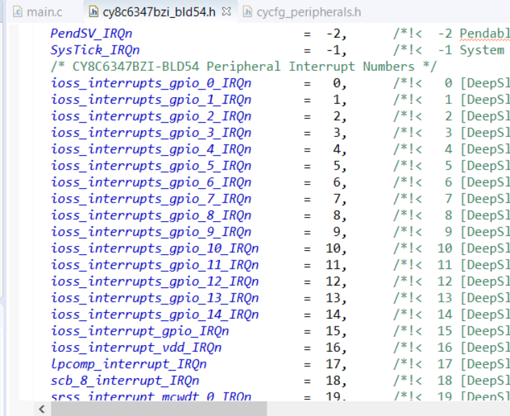

3) I want to use the the MCWDT module as an interrupt source but the only example I could find for the MCWDT module polls it based on when a button is pressed. The HAL and PDL both seem to have peripheral-specific ways of connecting the interrupt to the ISR and the 'Interrupt' documentation simply lists the API with (I think) only 1 code example for a GPIO port - and even then it does not explain how to work out what to put into the various config fields [example: for the 'IntrSrc' field, the documentation simply says 'Interrupt source'!!!]. And how to I do this for the CM4 - do I just ignore the fields that have 'CM0' in the name - I can't find anything that *explains* these things
Sorry if the documentation wasn't clear. All the interrupt sources are defined in the corresponding header file of the device. For example, if you are using the device "CY8C6347BZI_BLD54", then you can find this file inside "libs\psoc6pdl\devices\include\cy8c6347bzi_bld54.h".
However, to make things easier, if you have set up an interrupt on any peripheral in the device configurator, it automatically generates an interrupt macro mapped to the right interrupt source. You will find the interrupt macros defined for it in the file "cycfg_peripherals.h" present under "libs\TARGET_CY8CKIT-062-BLE\COMPONENT_BSP_DESIGN_MODUS\GeneratedSource\"
More elaborate explaination on API usage is given in the main page of every peripheral. Checkout SysInt (System Interrupt) main page in the PDL documentation for more information on usage.
