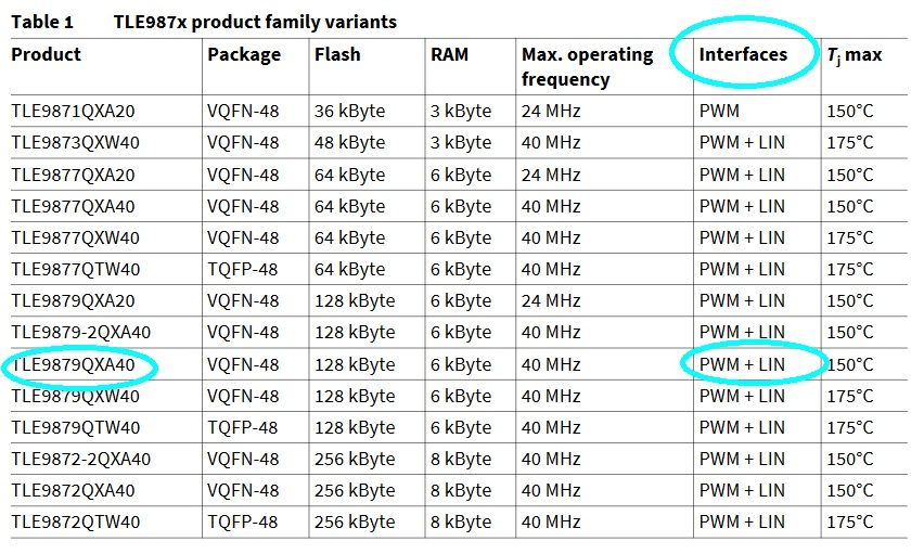

the HW Design Guide for the TLE987x describes a PWM interface in addition to the LIN-Bus:
Does anybody have any experience using this PWM Interface
and are there any examples for applying it?
Thanks for any info or pointers.

Hello John,
you can start by using the Timer2 PWm capture example from the SDK.
The example uses P1.2 to capture the PWM, but you can also use the LIN signal as external trigger for Timer2.

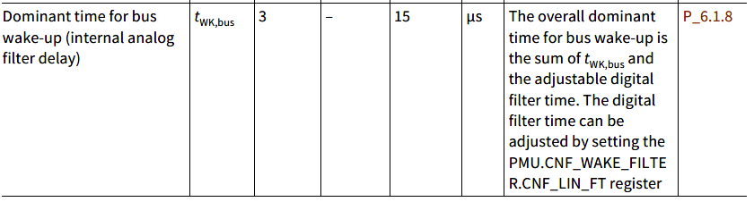

Hello John,
exactly the LIN transceiver has to be configured to LHVIO-mode.
Since the WMU (wake-up managment-unit) is actiavted when the LIN bus goes to dominant, the PWM can wake-up the device.
You only have to make sure that the dominant-pulse is long enough:
Best,
Fiz

Sep 06, 2021
03:03 AM
Sep 06, 2021
03:03 AM
Hello Fiz,
thanks for the confirmation and the note about the impulse time.
