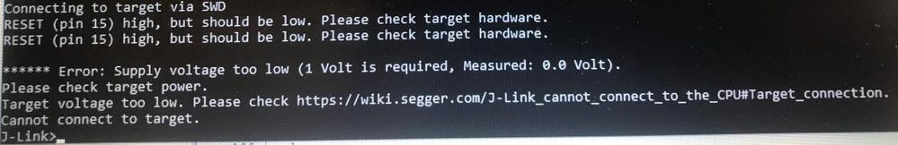

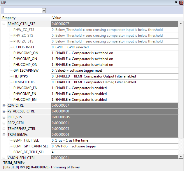

Thank you for your detailed reply Ivernot .
I tried it once as you gave,
and got the following results (see the attachment for details):
The system keeps prompting me "JLink Info: RESET (pin 15) high, but should be low. Please check target hardware.",then "Error: Flash Download failed-Target DLL has been cancelled".
I am trying to solve this problem by reading the official instructions:
https://www.infineon.com/dgdl/Infineon-TLE9879QXW40-DS-v01_01-EN.pdf?fileId=5546d4625b10283a015b248f...
https://www.infineon.com/dgdl/Infineon-AppNote-TLE986x-TLE987x-FAQ-Application-Hints_3-ApplicationNo...
https://www.infineon.com/dgdl/Infineon-Getting_Started_TLE986x-7x-GettingStarted-v01_01-EN.pdf?fileI...
Can you give me some more suggestions, what should I do next?
The device I am using is this REF_ENGCOOLFAN1KW(https://www.infineon.com/cms/de/product/evaluation-boards/ref_engcoolfan1kw/),
and Debug is: J-Link LITE-Cortex-M-5V
But nothing is displayed in the SWD window on the right. The official document says "SWD connection established when "IDCODE" is visible", but I don't know how to make "IDCODE" visible

- The J-Link Edu cannot be used to program the TLE987x products since it has 3.3V IOs.
I recommend to use the included J-Link Lite.

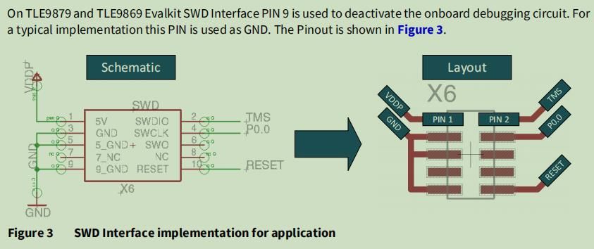

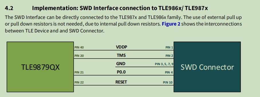

- Please make shure the SWD cable is connected in the correct orientation on the debug linker.
- Finally the target device needs to be supplied with 12V over the P and N terminals. (LED on the Board lights up, when supplied)

-I have connected DEBUGER and SWD-Debug Interface with SWD cable. The correct orientation you said, you mean connect the right connect the SWD cable to the corresponding interface, right?
-Yes, i think the main Setup is correct.

Hello Qian Su
I know it's frustrating getting started when the feedback is a bit 'slow'
FWIW: From how I understand Mc-Key's response it seem that you are 'close'
1. He confirms that the JLink Lite you have will work (and that the JLINK EDU will NOT!)
2. The samtec header must be plugged into the board the right way around. On my eval kit this connector is 'polarised' so I can't make it wrong 😞 But you should check documentatio that came with the Eval Kit.
3. The PCB must be externally powered from 12V - it will not run plugged into the JLink alone (sorry if this is obvious - but that has caught me in the past!)

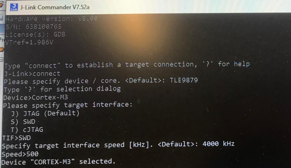

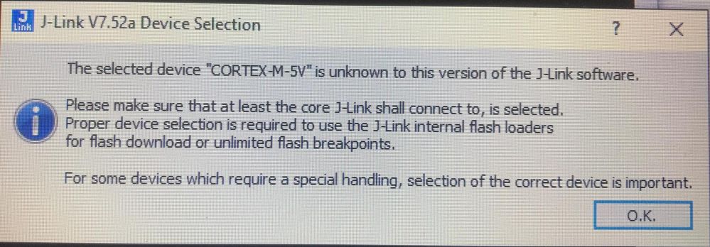

Something else to try.. you may already know that JLINK is a product of SEGGER.
As part of the Keil tools install the SEGGER utilities should also installed. (The JLINK utilities can also be downloaded from Segger direct - look for 'jlink download'.
You can use the 'JLINK Commander' to talk to the JLINK and test the connection to the target board.
This will at least confirm that JLINK to Target connection is working.
The JLINK commander is powerful tool but not 'obvious' to use - fortunately the documentation is excellent
Finally, have you tried to use a different computer or USB port or even different USB cable (long shot I know but...)

Hi Qian Su,
I can confirm post #9 from Ivan.
Please check the 12V supply of the board.
Without it the debug connection can't be established.

I talked to ARM-Keil and Segger, Determined the cause of this problem:
"The Basic J-Link <-> Target Connection Does Not Work Indicating a Hardware Setup Related Issue (Eg Wrong Pins Connected to the J-Link, Wrong Adapters Used , Broken Adapter, etc ...) ".
I tried to solve the problem through the boot of this page: https://wiki.segger.com/J-Link_cannot_connect_to_the_CPU#Target_connection , the result is :
"Error:Supply Voltage too low ( 1 Volt is required, Measured:0.0 Volt)"
Their guid is:
VTref is 0.000V
J-Link measures 0V target reference voltage. As the target reference voltage is used by the J-Link to create the levels of the debug signals, the reference voltage is mandatory.
1 :Check the power supply of the target hardware and verify that it is powered (switches on, jumpers are set correctly, etc...)
2:Measure the voltage between pin 1 (VTref) and pin 4 (GND) of the debug connector, using an multi-meter.
New Question:
1: Can it be determined that because the SWD interface on the side of the evaluation board does not get enough power,so it cause this problem? Still, is it possible to have a problem with the SWD interface on the DEBUGER side?
2:Because we have already determined the problem of insufficient voltage supply, these problems can be excluded right? : Switch ON, Jumpers Are Set Correctly, etc.....
3:Is the PIN 1 (VTREF) mentioned in the top mentioned page corresponding to the schematic diagram given by the above picture? But If so, PIN 4 is not GND in the picture above,PIN( 3,5,7,9) is GND.
4: This is the error in the manufacturer's hardware assembly, or is the software design error? How can I solve it next?
5: Mc-Key and Ivernot you said that the JLink Lite i have will work (and that the JLINK EDU will NOT!) right ? but peopel from Segger told me that The J-Link EDU also supports your device. I can purchase the J-Link EDU from AK Modul-Bus at:
https://www.ak-modul-bus.de/stat/segger_j_link_edu.html
I dont know who is right now .
6:Segger said they cant help me anymore .Because regarding to their policy,if people using J-Link LITE then "Support is given via the eval board manufacturer" . And i just learned , the Hardware v8 used by J-Link LITE is very old .
And even so, I found a pin in another interface next to Debugger's SWD interface is lack. Can I apply to Farnell to replace a Debugger ?
Looking forward to your reply!

I have tested the SWD hardware interface on the decoder side and the evaluation board side with a multimeter.
The SWD hardware interface on the evaluation board side has detected 5V power supply through PIN1 and PIN3, and the decoder side has less than 1V power supply.
Regarding the last time "RESET(pin 15) high, but should be low. Please check target hardware" and "Error: Supply Voltage too low (1 Volt is required, Measured:0.0 Volt)", can it be eliminated that the problem caused by the hardware?
4:If it is not a hardware problem, how can the above problems be solved?
5:(You can view the first few replies for related pictures)
If the above problem is fixed, can the problem about my excerpt of the J-Link dialog in Keil uVision not displaying normally be fixed?

q2213010 wrote:
I haven’t received any response from the last question I asked before, so I can only try to set the parameters according to my understanding, and then I have some of the following questions, hoping to be answered.
1: In addition to "FOC Motor Parameter", there are other parameter settings, such as "Boot Strap Loader", "Port" and "Interrupt".
Some of them are mentioned in the official tutorial video, but I can't Find relevant comprehensive documentation support. Where can I find them?
2:I still hope to get your confirmation for the question about "FOC Motor Parameter" mentioned earlier to ensure that my understanding is correct.
3:(You can view the first few replies for related pictures)
Qian Su
Dear Qian Su,
in order to shorten the debug effort on your side, I strongly recommend to you. Please purchase a TLE9879Evalkit. (https://www.infineon.com/cms/en/product/evaluation-boards/tle9879-evalkit/)
This Hardware is much easier to operate.
Nevertheless here are some answers:
1: The settings for in the Config Wizard are related to the chip modules. You can find the detailed documentation of each module in the TLE987x Users Manual (https://www.infineon.com/dgdl/Infineon-TLE987x-UserManual-v01_60-EN.pdf?fileId=5546d4624e24005f014e5...)
2 Please specify your question.
3 Something in your setup is not correct. The Reset Pin is low active. It needs to have a 5V level during normal operation. If the Pin has a low level, something is wrong. Please confirm that the 12V power supply is properly connected
4 If Reset Pin has a low level, the problem is most probably related to the hardware.
5 The pictures show, that no connection can be established. Please check your 12V power supply.
