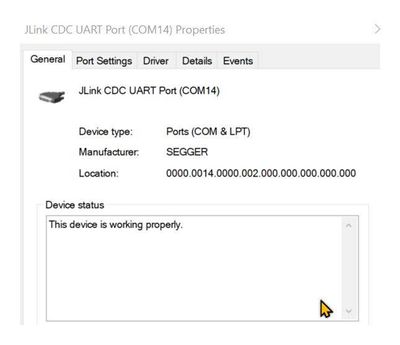

Hi Vinay - Many thanks for your suggestions. I've uninstalled & re-installed the (v7.66) J-Link code (several times with restarts), deleted the drivers in  DevManager, deleted & re-installed BPA Motor Control GUI...and an hour+ later...still no connection!
My DevManager shows the following - I've even gone in t the Segger folder & run the USB "InstDrivers.exe":
Any further help would be great.

I've now loaded this on to another PC - By loading in the new Segger USB drivers first, then installing BPA motor control. Whilst the BPA now shows "Segger Serial No XXXXX (disconnected)", on attempting to connect, I still get "An error occured while connecting".
