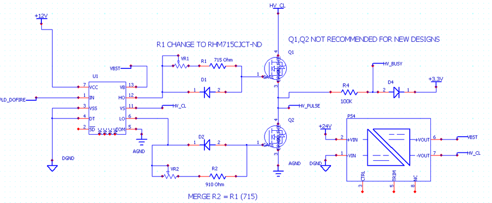

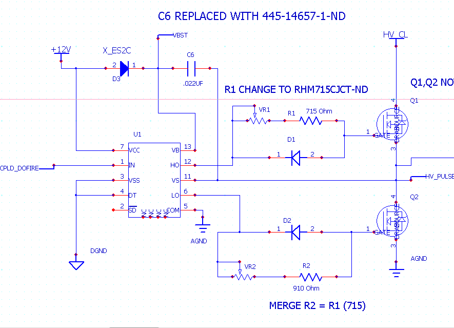

Hi, I'm trying to figure out how to use an H-Bridge driver chip without resorting to the boot strap cap method. The FETs themselves are switching a +96V circuit, and what I'd like to do is connect a +108V signal directly to Vboost. Is this possible? What other considerations do I need to make or take into account?
Thanks, Dan B.

Hello Dan,
The AGND should be connected to DGND for this IC. And please add a small capacitor between Vb and Vs as a filter.

so yo mean no bootstrap circuit is used in your application, and use a 108V connected to the VB pin, 96V to VS pin. Then please use a capacitor between VB and VS as a filter, the IC will work as expected.

Hi tengD, thanks for getting back to me. Here is the circuit I have now:
I'm going to add an isolated DC-DC converter to the circuit. And if I understand correctly, I should connect it like this?
Thanks again! Dan B.
