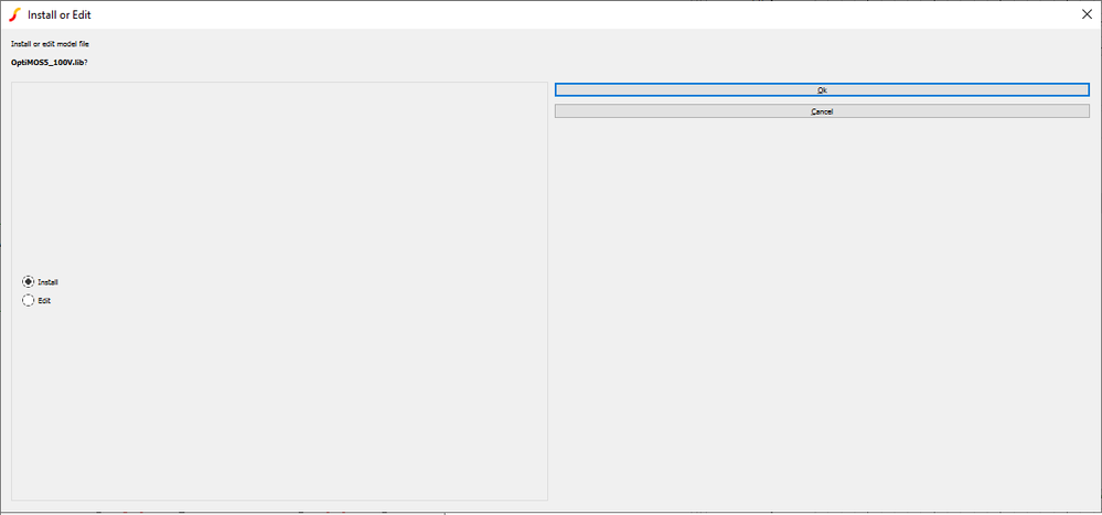

2) Add the library (.lib file) by extracting it and drag & dropping it to the Simetrix command shell (on the bottom left side of the main window) and pressing Install.
