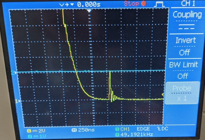

So as per the below image, I am seeing some considerable gate bounce as the MOSFETs transition from low to high switch. This is a half bridge (part of a 3 phase bridge) with IPT015N10 MOSFETs and 2EDL23N gate drivers, with 2.2R resistors on the gate.
I am running ~600ns dead time, and have verified (actually on another thread on the gate driver forum, that there is a peak of about 1A into the FETs gates. The switching looks really nice. I started investigating this only because it turns out my dead time was too short (accidentally set the dead time at 178ns owing to programming whoopsie)
When designing this, I followed the appnote "Parasitic Turn-on of Power MOSFET – How to avoid it?":
https://www.infineon.com/dgdl/Parasitic_Turn-on_of_Power_MOSFET.pdf?fileId=db3a30431ed1d7b2011eee756...
From this, I ascertained that the parasitic gate bounce witha 75V DC bus would be given roughly by:
75V*Crss/(Ciss-Crss)=75*80pF/(12000pF-80pF) = 0.5V
The ratio CGS/CGD is 150, which for a 75V rail, and by analogy to the appnote statement " is completely
safe against parasitic turn-on"
The problem is as in the pics below:
Ringing on the gate trace
4965.attach
This is how I am probing the gate - can't really think how to get a better measurement than this...
4966.attach
This clearly shows that the gate bounce at the switching event is much higher than the calculation from the appnote shows. There is no current flowing (nothing attached to the switch node) so this isn't intuitively inductive coupling, and probing the gate driver side of the gate resistor shows a lower amount of bounce, by approximately 1/3 - the ratio I would expect given the 2.2R resistor and the ~5ohm driver pull down impedance.
The gate driver has a very solid ground path between the PGnd and the FET source, a plane with the gate trace routed through it There is a ground plane directly below it. This is taken on the low side FET.
So the question is: Why am I getting this amount of bounce? Pretty much 10x as much as the appnote calculates I should get. Is it real, or is there some other explanation I am missing?
Further question: Is this a problem? It's only a 25ns wide blip, maybe that is so short that the effect is negligible?
Further question: If it is a problem, what should I do about it? I chose these FETs because they looked completely safe against parasitic turn on, I don't really want to go down the route of generating negative gate drive voltages etc, since this would eliminate my use of the 2EDL's over current protection and generally involve a lot more board space.

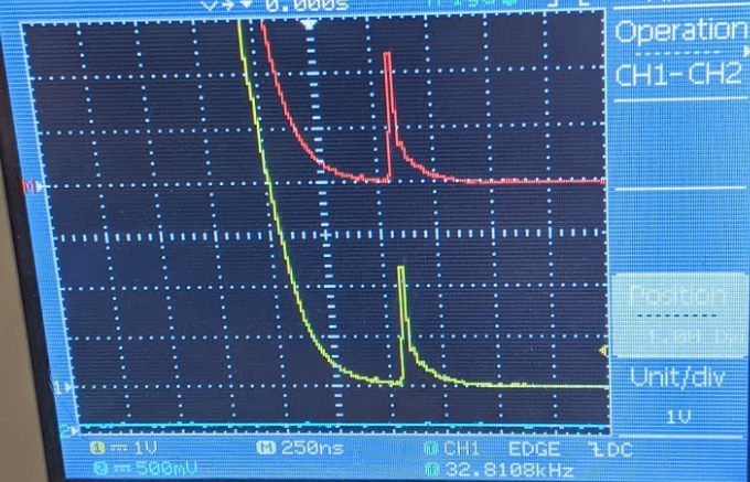

Jut an update with an image at 10x probe input, which seems to show there is some ringing on the scope cable that the extra probe resistance damps.
4967.attach
And there it is in relation to the switch node switching time.
4968.attach

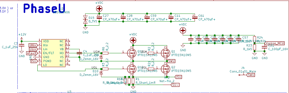

Can you please share the circuit that you have rigged up. It helps us in analyzing to what extent we can increase the gate resistance.
Abhilash P
User17346
10 replies posted 5 replies posted 5 questions asked

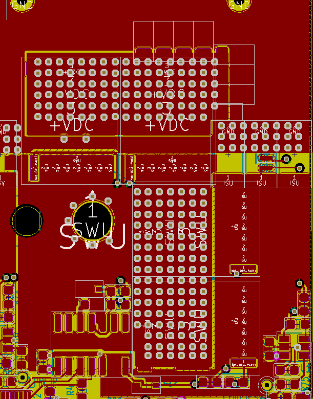

Below, excerpts from the schematic and layout of 1/3 phases. I am afraid I cannot post the full thing online. I have circled the 2.2R gate resistors in blue.
You can see there is a solid net returning the PGnd to the 2EDL, and the gate drive signal runs through the middle of it.There is a ground plane running directly below it. (yellow is a continuous plane on the top inner board layer).
I'll add that I have verified the pulses with two other much more expensive, higher end scopes with ground springs and 100MHz+ bandwidth, I'd post the results but it's pointless, they are identical... I didn't bother to save them.
I am interested in knowing the route cause of this spike, not merely slowing the circuit down to eliminate it (specifically I want to know why it looks exactly like a Miller bounce that the Infineon appnote says it should be completely immune to).
I am wondering:
Is the Infineon appnote wrong?
Are the FETs counterfeit (they seem to perform adequately otherwise, but the board was assembled by a low cost Chinese SMT outfit so it is a possibility)?
Is there another effect (source inductance for example, though at zero current I struggle to see why this would be the cause... parasitic output capacitance perhaps?
