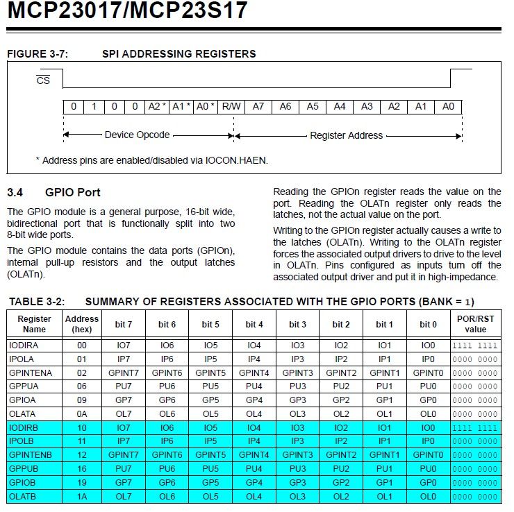

Datasheet about the input pin SI: SI information is read in on the rising edge of the SCLK. Input data is latched in the shift register and then transferred to the control buffer of the output stages. Databit D7 corresponds to Output OUT7 and D6 to OUT6 etc.

I have included an example of the type of information needed in order to work on supporting code for SPI. This is from a Microchip SPI expansion device. It is not a direct competitor for the Isolated ISO1H816G, but it demonstrates
the needed SPI support:
