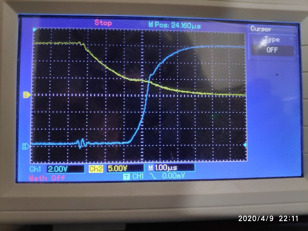

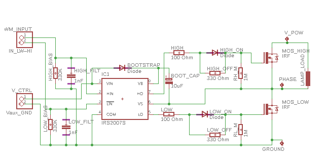

I am testing a single half of an H-Bridge with a light inductive load. I am using an IRF2007s driver for this.
4173.attach

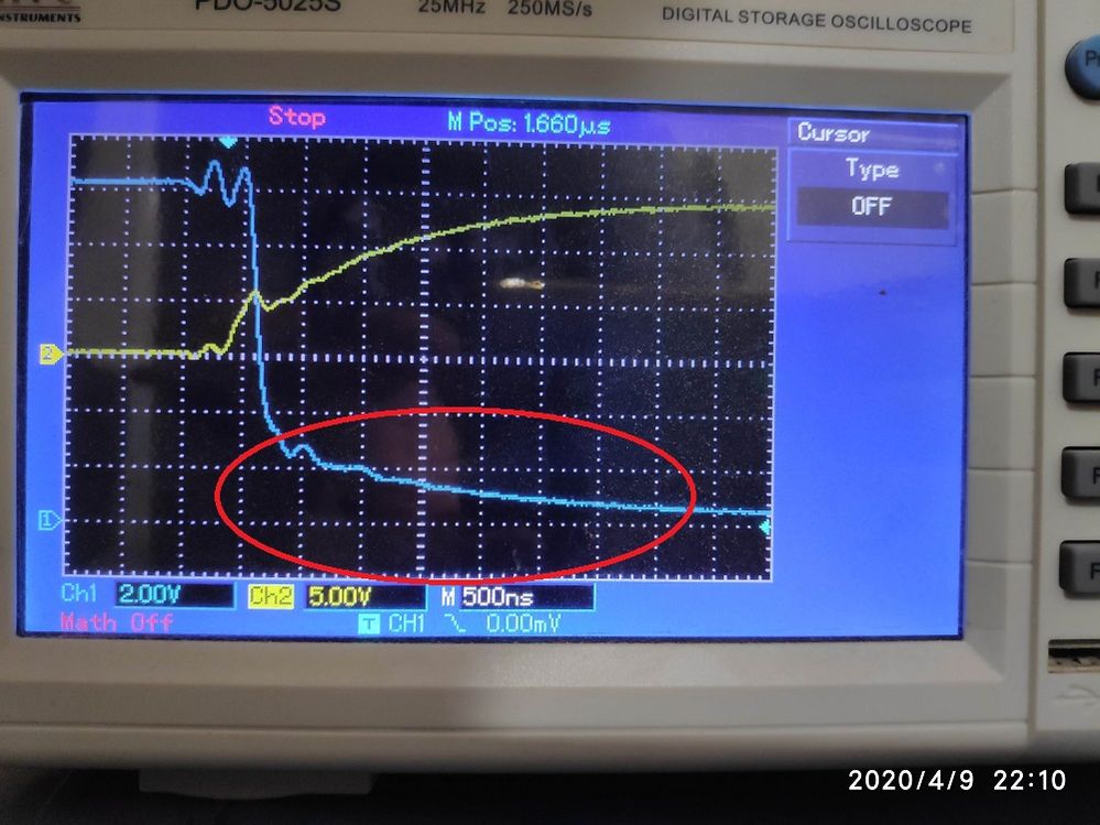

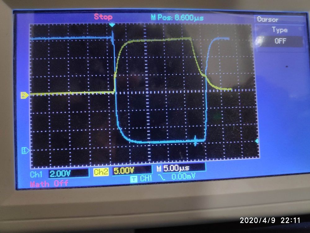

While testing the low side with a lamp which draws 3 Amps at 12V, I observe the following.
Blue - Phase - line
Yellow- Gate pulse (15V)
Complete pulse
4174.attach
Turn_off
4175.attach
Turn_on
4176.attach
I am not sure why the last phase of the turn on takes so long. Am I driving it wrong or is it a characteristic of the MOSFET.

The problem you are facing is similar to this image. The turn-on delay is due to turn on at a low current.
The capacitor charge during turn on due to charge carriers at a low current value creates this delay. If you switch at a high current value, the delay will be less.

The Gate resistors are much to high, try a few Ohms and remove Diode + 2. resistor.
You have to get 56µC in and out of the gate fast.
