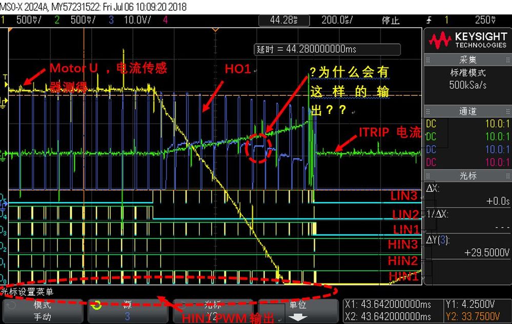

R2136 Hardware Over current ,Why Output waveform this?
Cboot=1uF,Rboot=10Ω
Cboot=1uF,Rboot=10Ω
- ir2136 fault

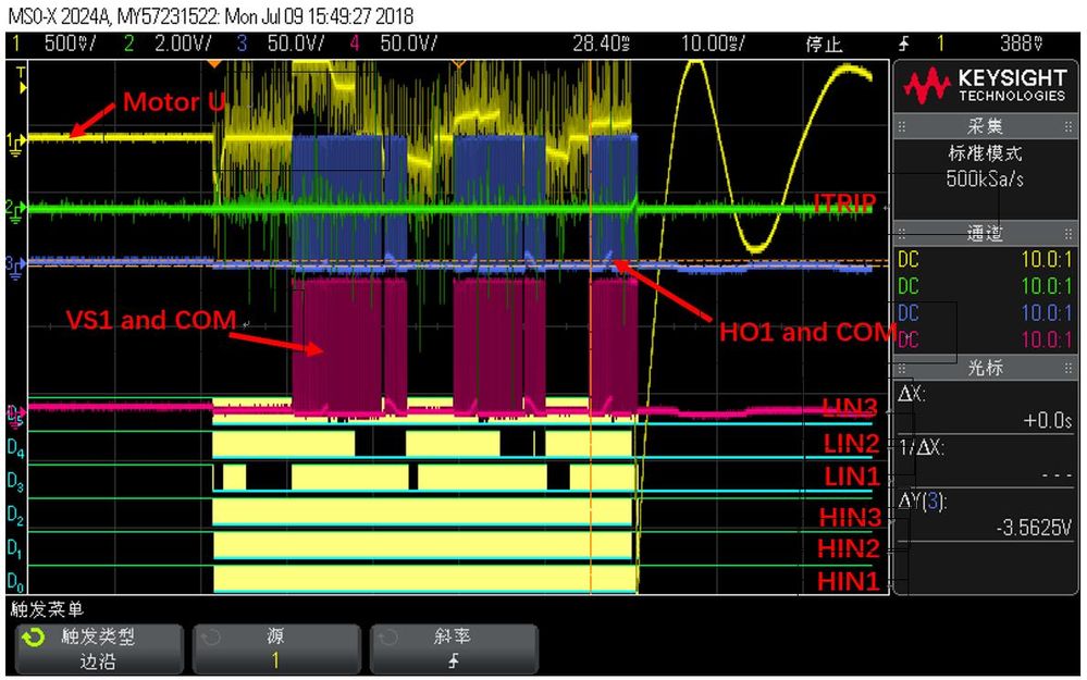

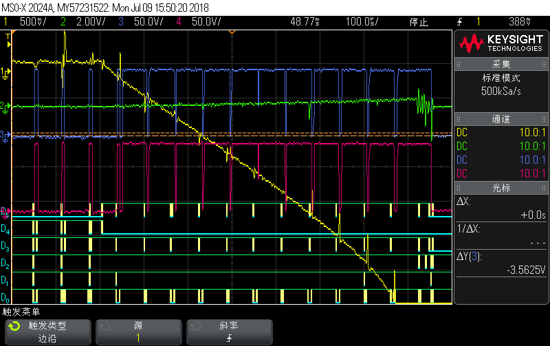

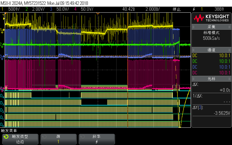

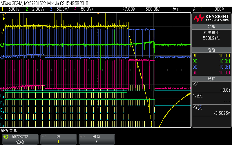

Hello Daisy ,
This waveform is HO1 and COM. I add measure the voltage between VS1 and COM.
Peng Yinkui
