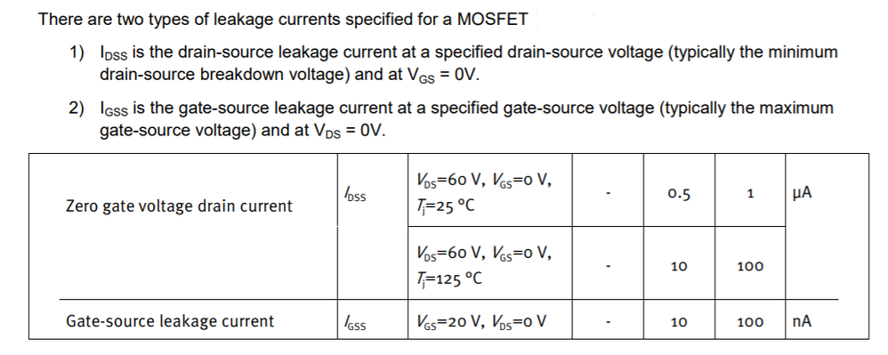

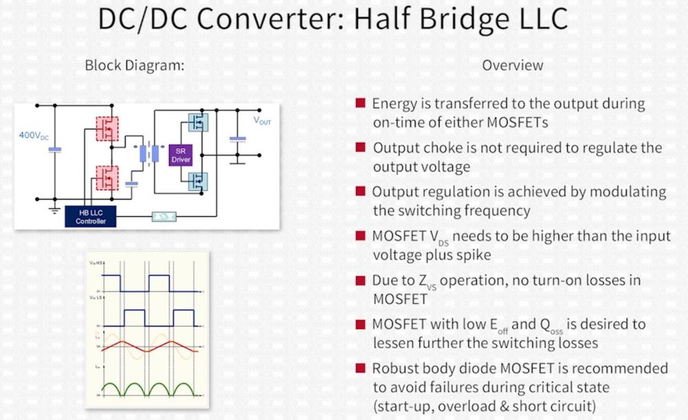

Can a half-bridge configuration, such as the following, be an efficient solution for the following requirement?
Requirement:
- Galvanic isolation between input and output
- Input: 12-24V DC
- Output: 5V DC @ 2A
What about SR losses? According to Infineon's chart, below, SR losses would exceed diode losses at our desired output. Is there a way to mitigate that, or an alternate topology?
From Infineon Video
https://youtu.be/LyhsaTeN-oQ?t=198

As per the required power specification, a Flyback topology is well preferred. It has less component count compared to half bridge and it is easy to control.
Please find the attached image with different DC-DC topologies,
4855.attach
Please revert back if you need any help in selecting the right switch and the package.
