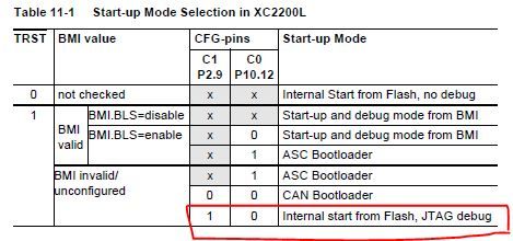

I'm trying to connect JTAG to fresh device of XC2234L that has never been programmed.
BMI is invalid because device is new. So, only things that I should configure for JTAG connection are P2.9=pulled -up, P10.12=pulled-down,and TRST=pulled-up.
But, I failed to connect via JTAG to a device. I'm using HITOP program with Miniwigger and 3rd party JTAG, TantinoXC to check connection between MCU and JTAG.
Is there something to check?

It is possible for a fresh from production XC2xxx LE device to boot into JTAG without program the BMI.
Like what Chad had said previously, the connection connected is P2.9=pulled -up, P10.12=pulled-down and TRST=pulled-up..
I'm not sure why you cant connected to the JTAG, for the pull up resistor, do you use at least a 10k ohm resistor?
You should use at least 10kOhm resistor for the pull up..
and make sure you have grounded the pin12 on the OCDS connector (please refer to easykit schematic).
This will make sure the miniwiggler go into JATG mode.. the miniwiggler will be in DAP mode..

Hi Jackson,
As you mentioned, I used 10K ohm pull-up resistor.
At the beginning, connection failed because I used 10k pull-down for P10.12. After changing to 1K ohm, JTAG was connected.
If TantinoXC debugger is used, firmware should be updated to the latest version.
